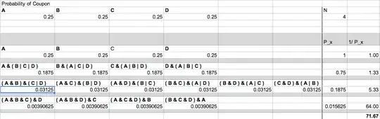

Am I then right in thinking $p_3$ would be $ p_ap_b(p_c + p_d) + p_ap_c(p_b + p_d) + p_ap_d(p_b + p_c) + p_bp_c(p_a + p_d) + p_bp_d(p_a + p_c) + p_cp_d(p_a + p_b) $
and $p_4$ would be $ p_ap_bp_c(p_d) + p_ap_bp_d(p_c) + p_ap_cp_d(p_b) + p_bp_cp_d(p_c) $ simplified to $4(p_ap_bp_cp_d)$
I put these values into a spreadsheet, but there's something I've done wrong. For the purpose of testing, I gave my coupons equal probability where I know the result should be 8.33. However, I'm getting the result 71.67 and can't see what is wrong. Any suggestions please?
