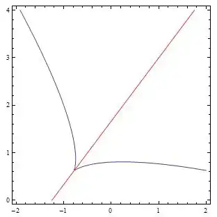

Here's a simple 2D example to experiment with: $$ 27 x^3 + 108 x^2 y + 144 x y^2 + 64 y^3 - 80 x^2 + 120 x y - 45 y^2 - 200 x + 150 y - 125 = 0$$ This one is symmetric, as the following picture suggests:
In fact, if we do the translation/rotation described by the substitution $u = \tfrac15(3x+4y)$, $v = \tfrac15(4x−3y) + 1$, then the curve is just $u^3 - v^2 = 0$, which is obviously symmetric about the line $v=0$.
But how would you discover this translation/rotation if I didn't tell you, and how would you do similar things in the 3D surface case?

    @apt1002 -- Good progress. Thanks. The plane of symmetry is actually $4x - 3y +5=0$, according to my calculations. This is perpendicular to the plane you gave. I checked your computation of the Laplacian, and it seems to be correct. – bubba Dec 05 '13 at 03:11

  • $27x^3+108x^2y+144xy^2+64y^3-80x^2+120xy-45y^2-200x+150y-125 = 125(u^3-w^2)$ with $5u=3x+4y$ and $5w=4x-3y+5$ –  Dec 10 '13 at 16:59
