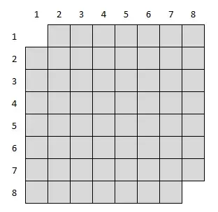

Imagine a 8x8 cell board that is missing two cells at the opposite corners, a domino takes up exactly two cells. How can you fill the board with dominoes so that none overlap or hang off the edge?

    Color it as a chessboard and count the number of white and black squares to see that it is impossible. – t.b. Aug 23 '11 at 07:27
    Before you ask "How can you fill the chessboard?" you should ask "Can you fill the chessboard?" – Aaron Aug 23 '11 at 07:29
This is a well-known problem - it even has its own wikipedia article: Mutilated chessboard problem.
Here you can find a few similar but more challenging problems for trominos.
Problems like this are usually solved using some type of coloring argument, as explained in Theo's comment and the above links.
