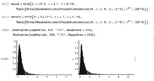

Added: The sum can not converge in probability to a degenerate distribution for $\alpha<2$, because $\mathbb{E}(Y_i^2) = \infty$ for $0<\alpha<2$, which implies the convergence in distribution should be to a distribution with infinite mean.
Simulation shows this is indeed the case:

I think I figured it out. When $0<\alpha<2$, $Y_i^2$ has a long tailed distribution. Specifically:
$$ Pr(Y_i^2 > z) \approx \frac{2}{\pi} z^{-\frac{\alpha }{2}} \Gamma(\alpha) \sin \frac{\alpha \pi}{2} $$
Therefore $n^{-\frac{2}{\alpha}} \sum_{i=0}^{n-1} Y_i^2$ is in the basin of attraction of the stable distribution and should converge to positive stable distribution with exponent $\alpha^\prime = \frac{\alpha}{2}$. One has to determine only the scale. To that end, the generalized CLT should be used which states that if a variable $X$ has asymptotic $F_X(x) \approx 1- c x^{-\alpha}$ for large $x$, and $F_X(-x) \approx d (-x)^{-\alpha}$ for large $x$, then $n^{-\alpha} \sum_{i=1}^n x_i$ converges in probability to $S\left(\alpha, \frac{c-d}{c+d}, 0, \left( \frac{\pi (c+d)}{2 \Gamma(\alpha) \sin \frac{\pi \alpha}{2}}\right)^{\frac{1}{\alpha}} ; 1\right)$. In the case at hand $d=0$ because $Y_i^2$ are non-negative.
Hence it seems that $n^{-\frac{2}{\alpha}} \sum_{i=0}^{n-1} Y_i^2$ converges in probability to $S( \frac{\alpha}{2}, 1, 0, 4 \pi^{-\frac{1}{\alpha}} \left( \cos \frac{\pi \alpha}{4} \Gamma( \frac{1+\alpha}{2}) \right)^{\frac{2}{\alpha}} ;1 )$.
Notice that the scale parameter becomes small as $\alpha \to 2^-$, which corresponds to the degenerate limit for normal variates.
