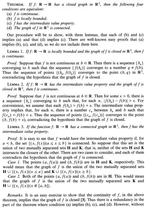

This Monthly paper has short simple proofs of the following
THEOREM$\ $ TFAE if $\rm\ f: \mathbb R\to \mathbb R\ $ has a closed graph in $\:\mathbb R^2$
(a)$\rm\ \ f\ $ is continuous.
(b)$\rm\ \ f\ $ is locally bounded.
(c)$\rm\ \ f\ $ has the intermediate value property.
(d)$\rm\ \ f\ $ has a connected graph in $\rm\mathbb R^2$.
More generally the result is merely a special case of R. L. Moore's 1920 characterization of a topological line as a locally compact metric space that is separated into two connected sets by each of its points.

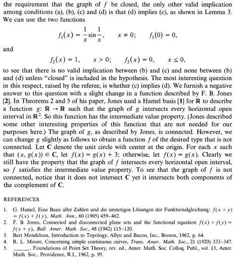

Per request, I've appended the proof of the theorem below.

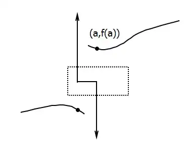

The answer is yes. Here's one way to prove it. (There might be a slicker way, but this seems to work.)
Assume $G$ is connected and closed. Let $a\in\mathbb R$ be arbitrary, and let $\epsilon>0$ be given. Because $(a,f(a)-\epsilon)\notin G$, the fact that the complement of $G$ is open implies that there is a product neighborhood of the form $(a-\delta,a+\delta)\times (f(a)-\epsilon-c, f(a)-\epsilon+c)$ contained in the complement of $G$. This means that $|x-a|<\delta$ implies that one of the following two inequalities holds:
  1. $f(x)\ge f(a)-\epsilon+c>f(a)-\epsilon$, or
  2. $f(x)\le f(a)-\epsilon-c$.
If there is any $x\in (a-\delta,a+\delta)$ so that the second inequality holds, say $f(b)\le f(a)-\epsilon-c$ (without loss of generality, we may assume $b\lt a$), then the graph of $f$ does not intersect the following set:
$$\\{(b,y): y\ge f(a)-\epsilon \\}\cup \\{(x,f(a)-\epsilon): b\le x \le a\\} \cup \\{(a,y): y\le f(a)-\epsilon\\}.$$
(See the diagram below.) This broken line disconnects $G$, contradicting the assumption that $G$ is connected. Therefore inequality (1) holds when $|x-a|<\delta$.
A similar argument shows that $f(x)\lt f(a)+\epsilon$ when $|x-a|<\delta$.
Putting these together, we conclude that $|x-a|<\delta$ implies $|f(x)-f(a)|<\epsilon$, so $f$ is continuous at $a$.
