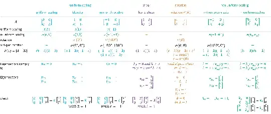

I created the following overview showing the eigenvalues and eigenvectors of elementary transformations corresponding to 2x2-matrices. The effect of these 'basic' transformations are easy to imagine, so once you can interpret the effect of these matrices, you will also understand the associated eigenvectors/eigenvalues.
$\mathcal{t}$ is 'a' linear transformation,
$\mathcal{s}$ is a scaling,
$\mathcal{r}$ is a rotation.
$\mathcal{o}$ is an oblique rotation: an oblique rotation rotates the basisvectors over different angles.
A 'normal' rotation $\mathcal{r}$ is an orthogonal rotation: all vectors are rotated over the same angle.
If you want me to add more info, just post a comment. You can also visit Heavisides Dinner.
overview table of elementary linear transformations
