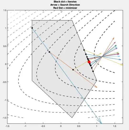

I've found two approaches to the algorithm.
Approach 1:
- $d_k = Pr(x_k-\nabla f(x_k)) - x_k$ : search direction projected onto feasible set
- $x_{k+1} = x_k + t_k d_k$
Approach 2: (Same as answer from p.s.)
- $y_k = x_k - t_k \nabla f(x_k)$
- $x_{k+1} = Pr(y_k)$ : Project $y_k$ onto feasible set
where $Pr$ is the projection operator.
I've found Approach 1 to work more reliably. Approach 2 fails to converge if the minimizer is on the edge of the feasible set and that edge is perpendicular to the objective gradient. For example, the search directions bounce around the minimizer in algorithm 2.
See here for matlab implementation https://github.com/wwehner/projgrad

1A note: approach 2 is an exterior point method whereas approach 1 is an interior point method, meaning that it relies on $x_k$ being feasible. – Brannon Sep 16 '22 at 14:03
How does Approach 1 guarantee that $x_{k+1}$ is feasible? Is there a formal name for this approach? – xadu Oct 19 '22 at 10:58
@Brannon Do you know some references on the subject? People seem to be referring to something different with interior point methods, but maybe I am misunderstanding something. – lightxbulb Dec 10 '22 at 10:06
It seems to me that approach 1 could occasionally lead to an $x_{k+1}$ outside the feasible set. The reason is that the projection is performed on the gradient, and the resulting gradient is subsequently modified with the learning rate $t_k$. For instance, when $t_k < 1$ and the feasible set is non-convex, or when $t_k > 1$ (although unlikely) and $x_k$ is near a corner of the feasible set. – kcoskun Jun 25 '23 at 11:08
It seems that approach 1 is the spectral projected gradient method https://www.ime.usp.br/~egbirgin/publications/bmr5.pdf – Suriya Feb 05 '25 at 22:36
