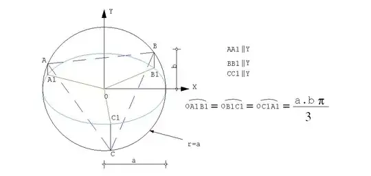

Describe a circle around the ellipse and the circle of an equilateral triangle we construct. Projection of points on the circle is an ellipse with the ellipse on the surface distribution of three equal parts. To divide into 5 the same procedure to construct a pentagon in a circle.

Scale in the $y$-direction until we get a circle, divide, scale back. Given the ellipse, if the division of the circle can be done with Euclidean tools, so can the division of the ellipse. If the construction must be done with straightedge and compass, this construction unfortunately excludes almost all odd numbers, though $3$ and $5$ are fine, since the equilateral triangle and the regular pentagon are Euclidean constructible.
Here is some detail. Suppose, for example, that the ellipse has equation $x^2/a^2+y^2/b^2=1$. Draw the circle with center the origin and radius $a$. Let $P$ be one of the division points of the circle. Drop a line from $P$ parallel to the $y$-axis until it meets the ellipse.
Whatever methods of construction are allowed, as long as they work for the circle and include the Euclidean tools, they can be extended to the ellipse.
