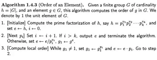

Alternatively we can use the following well-known simple order algorithm for groups (based upon the Order Test), from Cohen's book A Course in Computational Algebraic Number Theory.
alt text

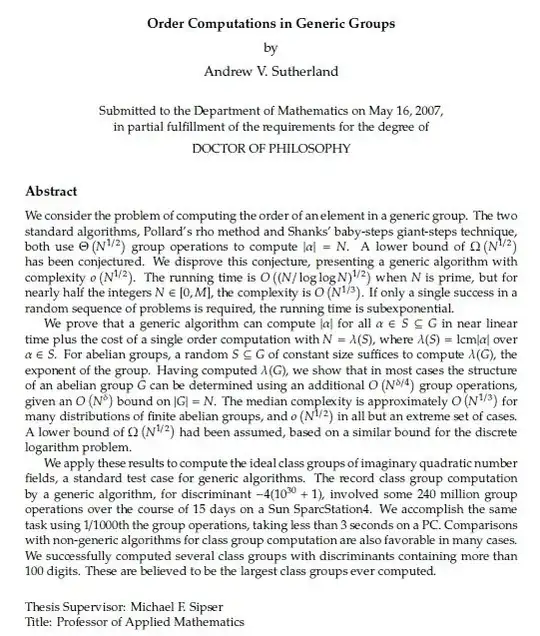

This thesis is a good reference on order algorithms in generic groups. Here's the abstract: alt text
