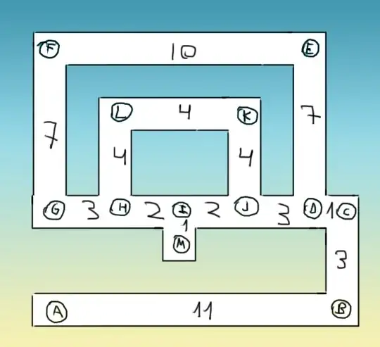

Hi, I want to know if there is an algorithm that allows me to visit every node in a graph, revisiting allowed, each node can have up to 4 linked nodes.
I uploaded the graph drawing as an example. In that example, one good route would be:
A - B - C - D - E - F - G - H - I - J - K - L - H - I - M
Summing weights:
11 + 3 + 1 + 7 + 10 + 7 + 3 + 2 + 2 + 4 + 4 + 4 + 2 + 1 = 61
But another route, with less weight, would be:
A - B - C - D - E - F - G - H - I - M - I - H - L - K - J
Weights:
11 + 3 + 1 + 7 + 10 + 7 + 3 + 2 + 1 + 1 + 2 + 4 + 4 + 4 = 60
Of course, I want to get the path with less weight. Revisited is allowed because otherwise I can't visit all nodes.
I'm not a Mathematician myself so easy talk would be much appreciated. I'm familiar with algorithms like A* and Dijkstra, that algorithms are useful when I have a target to search, but in this case I'm not searching a particular target.
Thanks!

    Why does your first example path end in M-I-J? You have already visited I and J earlier. – Fixee Aug 03 '11 at 00:10
  • Perhaps there is something obvious that I am not getting. How is this even a tree problem? – anon Aug 03 '11 at 00:20
  • This doesn't answer your question, but a shorter path is given by "A-B-C-D-E-F-G-H-L-K-J-I-M" (with a weighted cost of $56$). – JavaMan Aug 03 '11 at 00:22
  • @Fixee: yes, I should have finished at H-I-M, with a total weight of 61. thanks for taking note of that. anon: It is a graph problem, I believe. DJC: thanks – Veehmot Aug 03 '11 at 00:45
  • @Veehmot: You can (and should) edit your question to reflect this correction (and any others you might find). – Fixee Aug 03 '11 at 00:52
    The title could be more informative. – lhf Aug 03 '11 at 02:00
  • @Veehmot: consider cross-posting your question to cstheory.SE; that community specializes in this kind of problem (among other things). – Fixee Aug 03 '11 at 16:53

Is sounds like you want to generate a spanning tree of the graph, this is most commonly done with a depth-first or breadth-first search. Wikipedia has a short discussion of possibilities if you want to parallelise things.
Adding the consideration of weights, what you want is a minimum spanning tree, for algorithms, see, again, wikipedia.
Edit: As a good comment points out, the problem is not, given by finding a minimum spanning tree. It might still be a reasonable way to get a passable solution though.
Tilo Wiklund
  • 1,051
    I don't think this is simply MST: for MSTs there is no notion of cost for a single path visiting all nodes. – Fixee Aug 03 '11 at 00:13
  • True, I did have a suspicion my answer was somewhat premature. – Tilo Wiklund Aug 03 '11 at 00:46
  • Thanks, I'm looking into Kruskal's Algorithm and trying to do a simple application to implement it and prove if it is useful. – Veehmot Aug 03 '11 at 01:58
  • Thanks! I looked into both Kruskal and Prim's and ended up with the former. But as you told, it doesn't take into account a path, just return the edges. But still is a good aproximation. I'm still trying a brute force method. – Veehmot Aug 05 '11 at 03:29
  • I made a little demo to show my approach: http://www.youtube.com/watch?v=VbSwwos4R2E – Veehmot Aug 05 '11 at 03:49
A very similar problem is the Route Inspection Problem (aka the "Chinese Postman Problem"). That problem is exactly the same as yours, except that one must visit each edge rather than each node as you require.
I suspect that your variant is NP-Hard.
Strictly speaking, you asked only if "there is an algorithm" for your problem; there most certainly is: try all solutions and take the best one. Since there are a finite number of candidates, this is an algorithm.
If you want an efficient algorithm, I'm going to guess you won't find one. However, I would be pleased to be proven wrong.
Fixee
  • 11,760
  • Thanks for your time, I'm reading about MST as described earlier. I will compare and test all algorithms and ideas posted here, and pick the most efficient one. – Veehmot Aug 03 '11 at 01:59
It seems to me this is a variant on the Traveling Salesman Problem. You should have no trouble finding literature on this problem. The standard version is known to be NP-hard, which implies that no one knows a good algorithm for solving it in general (although there are very good algorithms for small instances, and very good algorithms for finding approximate solutions). Your restriction that each node have degree at most 4 may make the problem easier (but I doubt it).
Gerry Myerson
  • 185,413
  • Thanks. I have already read about TSP, but I think is different enough to have a different solution applied. Apart from the 4 degree restriction, the TSP problem can travel to any point, that is every city is connected to each other. In my example, there are specific "cities" linked together. – Veehmot Aug 03 '11 at 02:02
  • You can convert your problem to the TSP by adding virtual edges which correspond to the shortest multi-step path between each pair of nodes. – Kevin Reid Aug 03 '11 at 02:34
  • In the TSP problem, if you assign distance $10^{100}$ to any pair of cities that you don't want connected to each other, it reduces to your problem. – Gerry Myerson Aug 03 '11 at 02:58
You might find the discussion here of interest: https://stackoverflow.com/questions/5280594/travelling-salesman-with-repeat-nodes-dynamic-weights There are perhaps also ideas of interest to you in the book: The Vehicle Routing Problem, ed. Toth and Vigo, SIAM, 2002.
