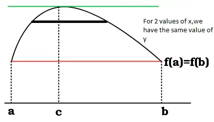

Since the function is continuous and f(0)=f(1) there there exist at least one c in [0,1] such that f'(c)=0.
It means the function has to have a critical point in [0,1]. Consider x < c. Then we will have some c+h(h>0) which will be equal to x.enter image description here
