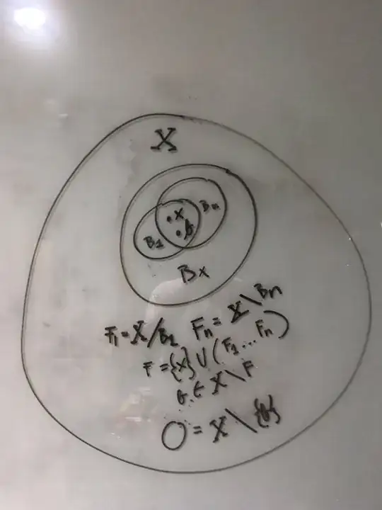

Cofinite topology is not first countable. To prove it, we show that some point of $X$ does not have a countable local base.
Let $x \in X$, and suppose that $\mathscr{B_x}=\{B_n:n\in\Bbb N\}$ is a countable local base of open sets at the point $x$.
For each $n\in\Bbb N$, let $F_n = X \setminus B_n$. $B_n$ is open, so by definition $F_n$ is finite. Let $F = \{x\} \cup \bigcup_{n \in \Bbb N}F_n$; $F$ is the union of countably many finite sets, so $F$ is countable. $X$ is uncountable, so there is some $b\in X\setminus F$ (and $b \neq x$).
Note that if $X$ is not a cofinite topology, then $F$ is not necessarily countable, then $b$ does not necessarily exist.
Let $O = X \setminus \{b\}$. $\{b\}$ is finite, so by definition $O$ is an open set, and it contains $x$ (because of how $b$ defined). For every $n \in \Bbb N$, we know that $b \notin F_n$, so $b \in B_n$, but $b \notin O$, so $b \in B_n \setminus O$, and therefore $B_n \notin O$.
In summary, there is an open set $O$ containing $x$ but not containing $B_n$. This is a contradiction.
We may wonder though what happens if we define $O = X \setminus \{b\}$ in the usual topology. If the local base is an open ball $B(x, \epsilon)$, there would always be $\epsilon < d(x, b)$.
Picture to see things clearer
