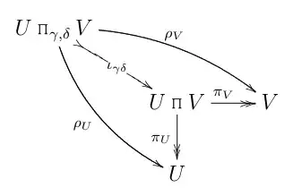

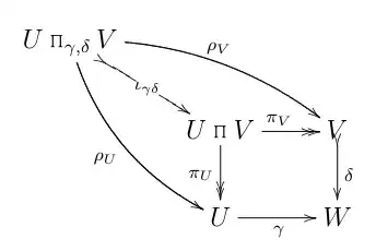

While working through an arrow-pushing/diagram-chasing exercise, I drew this diagram
Innocent-looking, but wrong
(FWIW, all these diagrams are in good ol' Set.)
Here, $U\;\Pi_{\gamma,\delta}\;V$ is the binary relation
$$ \{(u, v) | \gamma(u) = \delta(v) \} \subseteq U \times V = U \;\Pi\; V, $$
and $\rho_U, \rho_V$ are given by $\rho_U((u, v)) = u, \rho_V((u, v)) = v$. The maps $\pi_U, \pi_V$, of course, are the canonical projections of the product $U \;\Pi\; V$. (Two-headed arrows denote epimorphisms, and "tailed" arrows, like the one for $\delta$, denote monomorphisms.)
The diagram sure looked innocent enough at first: nothing more than the usual categorical pullback (which here I'm calling $U\;\Pi_{\gamma,\delta}\;V$, to suggest a "fibered product"):
The usual categorical pullback
...conveniently outfitted with its inclusion $\iota_{\gamma,\delta}$ into the usual categorical product:
Inclusion into the usual categorical product
Needless to say, I soon began deriving (from the first diagram above, that is) some obviously nonsensical conclusions, such as "$\delta$ is monic $\Rightarrow \pi_U$ is monic $\Rightarrow U\;\Pi\; V \cong U$".
It took me a looong time to figure out that the source of the errors was incorrectly treating this subdiagram as commutative:
This is very wrong!
Of course, except for special cases (e.g. $V \cong W \cong \mathbf{1}$, the singleton), this last diagram is wrong.
I'm sure there's a moral to this story (other than "Diagrams are trickier than they look" and "Don't be stupid!"), but I have not quite figured it out yet.
