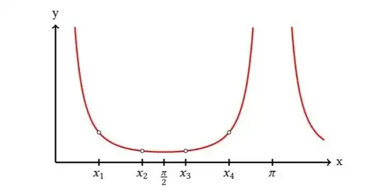

The starting point is the following practical formula:
$ (\cos x + i \sin x)^n = \cos(nx) + i \sin(nx) $
It is a direct consequence of Euler's identity $e^{ix} = \cos(0) + i \sin(0)$: you obtain De Moivre's formula if you apply Euler's identity to either side of the equation:
$ (e^{ix})^n = e^{inx} $
Dividing by $\sin^n x$, we also have
$ \frac{\cos(nx)}{\sin^n x} + i \frac{\sin(nx)}{\sin^n x} = \left(\frac{\cos x + i \sin x}{\sin x}\right)^n = (\cot x + i)^n $
We can rewrite the last expression using the binomial theorem:
$ = \left[\binom{n}{0} \cot^n x - \binom{n}{2} \cot^{n-2} x + \binom{n}{4} \cot^{n-4} x - \ldots\right] + i \left[\binom{n}{1} \cot^{n-1} x - \binom{n}{3} \cot^{n-3} x + \binom{n}{5} \cot^{n-5} x - \ldots\right] $
Case 1: $n = 2m + 1$ (odd)
Comparing the imaginary parts of the above expression, we find
$ \sin(nx) \sin^n x = \binom{n}{1} \cot^{n-1} x - \binom{n}{3} \cot^{n-3} x + \binom{n}{5} \cot^{n-5} x - \ldots \pm \binom{n}{n} \cot^0 x = \binom{n}{1} \cot^{2m} x - \binom{n}{3} \cot^{2m-2} x + \binom{n}{5} \cot^{2m-4} x - \ldots \pm \binom{n}{2m+1} \cot^0 x $
$ = \binom{n}{1} (\cot^2 x)^m - \binom{n}{3} (\cot^2 x)^{m-1} + \binom{n}{5} (\cot^2 x)^{m-2} - \ldots \pm \binom{n}{2m+1} \cdot 1 $
$ = P(\cot^2 x) $
where $(P(x_i) = \sum_{k=0}^{m} a_k x_i^k)$ with $ a_k = \binom{n}{2m+1-2k}$
$P(x_i)$ is a polynomial of order $m$ and by the fundamental theorem of algebra has $m$ zeros $x_{i_1}$, $\ldots$, $x_{i_m}$. As we've established that $(P(\cot^2 x)$ = $\frac{\sin(nx)}{\sin^n x}$ it is easy to see that with $(x_k = \frac{k \pi}{n}$ the polynomial becomes zero for the $m$ distinct arguments $(x_i^k = \cot^2(x_k)$
$ P\left(\cot^2 x_k\right) = P\left(\cot^2 \left(\frac{k \pi}{n}\right)\right) = -\frac{\sin(k \pi)}{\sin^n\left(\frac{k \pi}{n}\right)} = 0 $
With this knowledge, we can rewrite the polynomial $P(x_i)$ as:
$ P(x_i) = a_m(x_i - x_{i_1})(x_i - x_{i_2}) \ldots (x_i - x_{i_m}) = a_m x_i^m - a_m (x_{i_1} + x_{i_2} + \ldots + x_{i_m}) x_i^{m-1} + \ldots $
Comparing this with the previous expression, we can infer that
$ x_{i_1} + x_{i_2} + \ldots + x_{i_m} = \frac{a_{m-1}}{a_m} = \frac{\binom{n}{3}}{\binom{n}{1}} = \frac{n!}{(n-3)!3!} \cdot \frac{n!}{(n-1)!1!} = \frac{(n-1)(n-2)}{6} = \frac{2m(2m-1)}{6} = \frac{2m(2m-1)}{6} = \frac{2m^2 - m}{3} $
Next, we'll use the identity
$ \cot^2 x = \frac{\cos^2 x}{\sin^2 x} = \frac{1 - \sin^2 x}{\sin^2 x} = \frac{1}{\sin^2 x} - 1 $
So,
$ \cot^2 x_1 + \cot^2 x_2 + \ldots + \cot^2 x_m = \left(\frac{1}{\sin^2 x_1} - 1\right) + \left(\frac{1}{\sin^2 x_2} - 1\right) + \ldots + \left(\frac{1}{\sin^2 x_m} - 1\right) = \frac{2m^2 - m}{3} $
or equivalently
$ \frac{1}{\sin^2 x_1} + \frac{1}{\sin^2 x_2} + \ldots + \frac{1}{\sin^2 x_m} = \frac{2m^2 + 2m}{3} $
As a consequence of $\frac{1}{\sin x}$'s symmetries, the sum of the $k = m + 1$, $2m$ terms has the same value as the sum of the $k = 1$, $\ldots$, $m$ terms.
We've established that
$ \frac{1}{\sin^2 x_1} + \ldots + \frac{1}{\sin^2 x_{2m}} = \frac{1}{\sin^2 \left(\frac{\pi n}{n}\right)} + \ldots + \frac{1}{\sin^2 \left(\frac{\pi (n - 1)}{n}\right)} = \sum_{k=1}^{n-1} \frac{1}{\sin^2 \left(\frac{\pi k}{n}\right)} = \frac{2(2m^2 + 2m)}{3} = \frac{(2m + 1)(2m + 1) - 1}{3} = \frac{n^2 - 1}{3}. $
This completes the proof for the case of odd values of $n$
