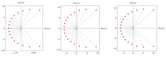

for some values on alpha (e.g. solve sum_(k=0)^19 z^k/(k!) = 0 for z), I made a few observations:
  • The sum of the roots of $f_N$ are $-N$
  • The product of the roots of $f_N$ are $(-1)^N\cdot N!$
  • Their imaginary part seems to lie between $\pm10$
  • The zeros seem to form an interesting shape:
Patterns for $N=17, 18, 19$
Now the sum and product part are clear, since
$$\begin{align} f_N(x) &= \frac1{N!}\left(z^N + N z^{N-1} + N(N-1)z^{N-2} + ... + N!\right) \\ &= \frac1{N!}(z-z_{N0})(z-z_{N1})\cdots(z-z_{NN}) \\ &= \frac1{N!}\left(z^N - \left(\sum_{k=0}^Nz_{Nk}\right) z^{N-1} + ... + (-1)^N\prod_{k=0}^N z_{NK}\right) \end{align}$$
and since $e^z=0 \Leftarrow \Re z\to-\infty$ it is clear that the roots tend towards real parts with negative infinity, but I'm still intrigued by the questions
what ($N$-dependent) curve do the zeros of $f_N(z)$ lie on, does that curve maintain its shape for varying $N$ and merely translate or also deform; and what other properties of the zeros (e.g. absolute value) can be derived?

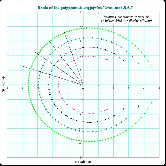

One more picture; here I rescale the radial distances from the origin to their logarithm; the roots of the polynomials $f_{16},f_{32},f_{64},f_{128}$ are shown, the magenta line is that for $f_{16}$. I find it interesting, that the radial positions fit nicely together, see the straight lines from the origin (the roots do not exactly match with the lines but remarkably good)
  • So in other words, you plot on a log-log scale, right? Wow, that's an interesting observation! Also interesting: The amount of roots between two such lines appears to be of the form $2^n-1$ – Tobias Kienzler Oct 30 '13 at 08:49
  • Well, that's not quite the correct transformation. In fact, if I do separately rescale the x-axis and the y-axis, then the curves approximate squares (you might try this using an asinh-scaling instead, which becomes quite similar to a log-log-scaling for values >1). No, here I compute the polar coordinates of the roots, rescale the distance to the origin $\sqrt{\Re(\rho)^2+\Im(\rho)^2}= |\rho| $ by logarithmizing and recalc the rectangular coordinates from that. – Gottfried Helms Oct 30 '13 at 09:10
  • @tobias:the number of roots between two such lines plus that on one line is just 2^ because the number of complex roots is just doubling with each step. – Gottfried Helms Oct 30 '13 at 09:14
  • Ah true, it's too early in the morning... I wonder if the roots really don't lie exactly on these line or whether that's numerical accuracy... Also, the real roots seem to be very regularly spaced – Tobias Kienzler Oct 30 '13 at 09:22
  • @Tobias: Yepp. Do you have Pari/GP? It was no problem to get the 128 roots by the simple call
     polroots(Pol(exp(x) + O( x^2^7))))
    in just a second.(One should increase the default powerseries precision and the computing precision sufficiently high)
    – Gottfried Helms Oct 30 '13 at 09:37
  • I'm usually using Python or Wolfram Alpha, but I'll have a look at it, thanks! – Tobias Kienzler Oct 30 '13 at 09:43
