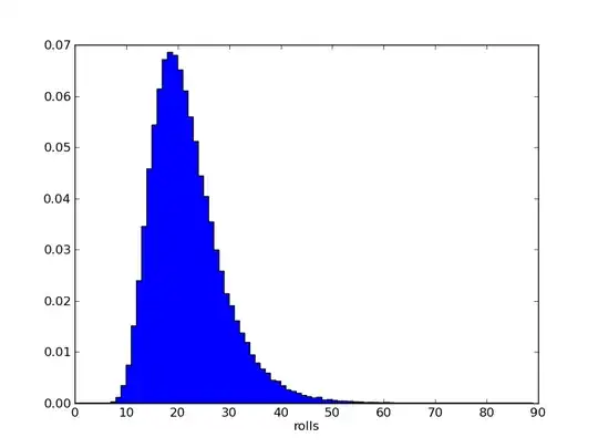

Sometimes insight can be gained by sampling the distribution. This doesn't prove anything but it helps validate and supplement other answers. I attached a short python script to sample $10^5$ of your games. In addition to plotting the mean, it is simple to not only estimate the higher order moments, but the actual shape of the distribution:
The results of a Monte-Carlo sampling indicate that @awkward's answer is correct:
Monte-Carlo, mean, std: 21.42546, 6.92985885775
@awkward's answer : 21.4298245245
Code below:

Hooked
