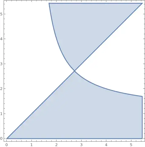

The equation $x^y=y^x$ has solution along the bisector $y=x$ and along a curve symmetric with respect to the bisector. In the following image the gray region is where $x^y > y^x$
A parametric representation of the curve is $(e^{f(t)},e^{f(-t)})$ where $$ f(t) = \frac{t}{e^t-1} $$

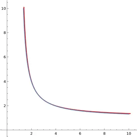

A curve very similar to that is the equilateral hyperbola $$ (x-1)(y-1) = (e-1)^2 $$ and here there is a graphical comparison between the two curves
So a possible test with very low error is, assuming $x < y$ $$ (x-1)(y-1) > (e-1)^2 \quad \Leftrightarrow \quad x^y > y^x $$
