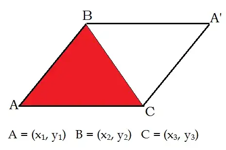

You know that AB × AC is a vector perpendicular to the plane ABC such that |AB × AC|= Area of the parallelogram ABA’C. Thus this area is equal to ½ |AB × AC|.
From AB= $(x_2 -x_1, y_2-y_1)$; AC= $(x_3-x_1, y_3-y_1)$, we deduce then
Area of $\Delta ABC$ = $\frac12$$[(x_2-x_1)(y_3-y_1)- (x_3-x_1)(y_2-y_1)]$
