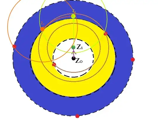

It follows that we can use the recentering trick somewhat indirectly. This picture gives the idea: the red dots are the isolated singular points. We begin with the Laurent series on the yellow ring and we want to discover the coefficients on the blue annulus.
Laurent Recentering
If we can obtain values for $f(z)$ on a contour in the blue ring which is smoothly deformable to a circle in the blue ring then that means by Laurent's Theorem we can derive the coefficient which uniquely prescribe the Laurent decomposition with center $z_o$ in the blue annulus. So, Weierstrauss' technique of recentering would seem to get us the values for a continuation to the brown annulus which gives us some of the values we need. Now, what I am not sure of at the moment, is, if the singularities block us from obtaining the closed contour of values which we need. In any event, actually carrying this out for a specific example seems rather involved... unless... we obtain the global formula for $f(z)$ as in your geometric series example. Then the expansion naturally flows from our knowledge of the global formula which is not really what you're after.
James S. Cook

  • You understood my question perfectly - were the global formula known there'd be no need to attempt obtaining the blue coefficients from the yellow ones (nice illustration btw). So far I got the impression no analytical formula is possible, merely an algorithm: Slightly move the yellow annulus centre to obtain values in a small part $B_1$ of the blue annulus (if the radius shrunk instead of growing, you moved towards a singularity and need to choose a different direction). Now, choose a circle inside $B_1$ and Laurent-expand there to obtain values in a larger part $B_2$. Rinse and repeat... – Tobias Kienzler Oct 27 '14 at 19:11
  • ...until you got values along a closed curve in the blue annulus (the outer radius of which you actually don't know yet) and use that path to Laurent-expand around the original centre. However there doesn't seem to be a guarantee that one doesn't accidentally skip the blue annulus and obtain the coefficients from the second-to-next annulus or even further out... – Tobias Kienzler Oct 27 '14 at 19:13

(Expanding my comment on James' answer)
James already provided a nice picture, which I'll build upon here:
At the moment, I don't know of an analytical formula, but the algorithm is this:
  • Given: the Laurent-series in the yellow zone, delimited by $r<|z-z_0|<R$
  • Sought: the one in the next-outer blue zone, delimited by $R<|z-z_0|<{\color{blue}{R_b}}$ (it's straightforward to modify all this for switching to a smaller annulus)
  • Shift the centre to a point $z_1$ which lies not in direction of a singularity that causes $R$ to be $R$ (which can be verified by checking the new $R_1$)
  • Use the $z_1$-series to obtain values in a small section of the blue annulus around $\color{lime}{z_3}$, put them into the formula for a Laurent-series expansion (actually, Taylor, since we avoided the singularity - to do expand around the singularity instead for fewer steps?) in that small section of blue, with convergence radius $\color{lime}{R_2}$
  • move along the yellow-blue interface towards the convergence boundary at $\color{orange}{z_3}$, Taylor-expand there
  • go on until a full circle is available (when approaching singularities on the interface, go round them via the blue zone)
  • use the Laurent-expansion with that bumped-circle around $z_0$
