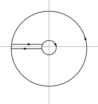

To evaluate $J(a)$, consider the following contour integral in the complex plane:
$$\oint_C dz \frac{z^a}{z^2-\sqrt{5} z+1}$$
where $C$ is a "keyhole" unit circle, with the keyhole being about the negative real axis, as pictured below.
By the residue theorem, this contour integral is equal to
$$-i 2 \pi \phi^a$$
where $\phi = (\sqrt{5}-1)/2$ is the golden ratio. On the other hand, the integral is also equal to
$$-i J(a) + i 2 \sin{\pi a} \, \int_0^1 dx \frac{x^a}{x^2+\sqrt{5} x+1}$$
Note that the portion of the integral that goes about the center goes to zero. Therefore we have
$$J(a) = 2 \pi \phi^a + 2 \sin{\pi a} \, \int_0^1 dx \frac{x^a}{x^2+\sqrt{5} x+1}$$
