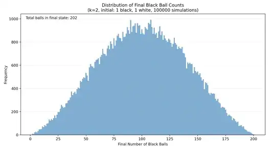

Here is a histogram from simulating the case where $k=2$ and $m_0=n_0=1$, running for 100 time steps.

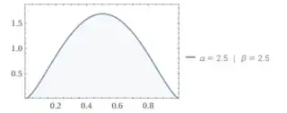

It looks qualitatively similar if I increase or decrease the number of steps. The main question is what distribution this is converging to (as a function of $n_0, m_0$ and $k$). In this case it could plausibly be a beta distribution with parameters at some non-integer value between 2 and 3:
but it could equally be something else.

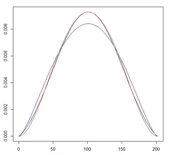

It is not quite a beta distribution. With your example of $100$ draws of $2$ balls starting with $1$ of each, I think $\alpha=3, \beta=3$ gives a reasonable fit for the peak of the distribution (in red below; you also asked about $\alpha=2.5, \beta=2.5$ shown in blue below but it is a worse fit for the peak); the quite good parameters fall slightly with more draws.
Here is some R code which avoids simulation, shown in black below

plot((0:balls), c(0,currentdist), type="l") curve(dbeta(x/balls,3,3)/balls, from=0, to=balls, col="red", add=TRUE) curve(dbeta(x/balls,2.5,2.5)/balls, from=0, to=balls, col="blue", add=TRUE)

  • How does it look with $\alpha=\beta=2.5$ or some other non-integer value between 2 and 3? It looked to me like that might fit a bit better, especially near the end points, because the derivatives of the true curve don't go to 0 there. – N. Virgo Jan 04 '25 at 18:20
    @N.Virgo added to the chart in blue – Henry Jan 04 '25 at 20:41
