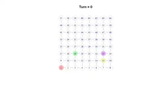

I thought of a game that involves a square lattice graph (e.g. 8x8). At turn=0, we randomly pick 4 nodes ("source nodes") and color each one a separate color :

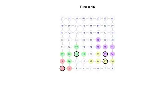

In each turn, a color is randomly selected and has the option to pick any node touching one of its nodes and claim that color - for example (at the end of turn 16, the board looks like this):

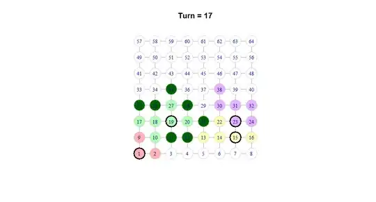

For example, suppose at turn = 17, green is selected. Green has the option of coloring any of the following nodes (in dark green):
