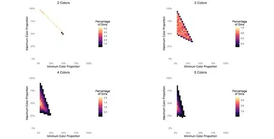

For example, if there are more than 2 colors, it seems to hard define a ratio of colors. In this case, I thought of defining the distribution of the most popular color vs the least popular color after a certain number of simulations. I tried to do this in R (starting with an equal number of balls):

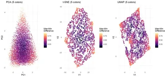

While a bit unorthodox, I then tried to use some Machine Learning based dimensionality reduction techniques to visualize the results from a different perspective (this uses the actual final proportional of all colors in each simulations):
