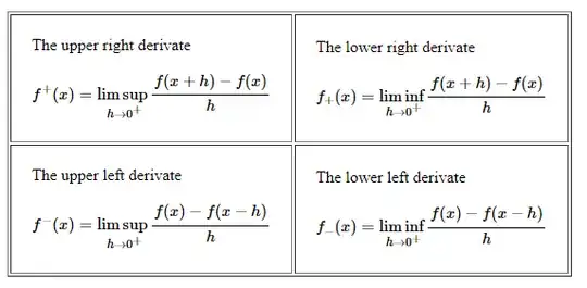

I'm dealing with a calculus exercise. Let me first explain my notation: I say $f_-^\prime(x)$ exists provided the limit $\lim_{t\to x^-}\frac{f(t)-f(x)}{t-x}$ exists. Also we define four Dini derivatives: enter image description here

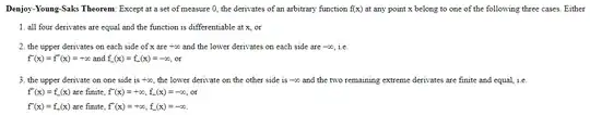

I'm confused with this problem. First of all, my search of internet suggested me the following theorem (here): enter image description here therefore it seems that the problem follows from the theorem, since the existance on the interval $(a,b)$ suggests that one-side derivative exists and finite except for possibly two points (the endpoints of an interval), which measures zero. However, I don't think this is the right way to solve this, since I don't think it is proper to use such a profound result on an exercise from my textbook.
Can someone provide an alternative approach to solve this? Thanks for your advice.
