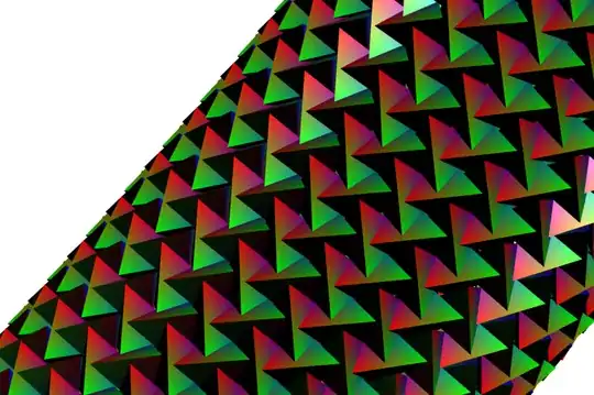

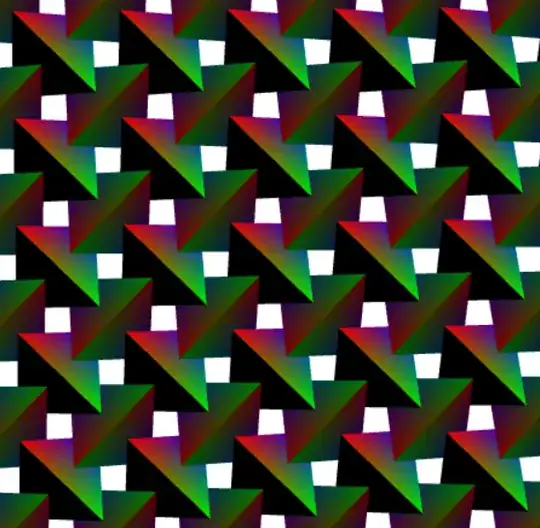

So here's the stable cluster given in Winkler's book. We take the asteroid shape to be a regular tetrahedron, and then arrange them to form the following pattern:
hi
hi

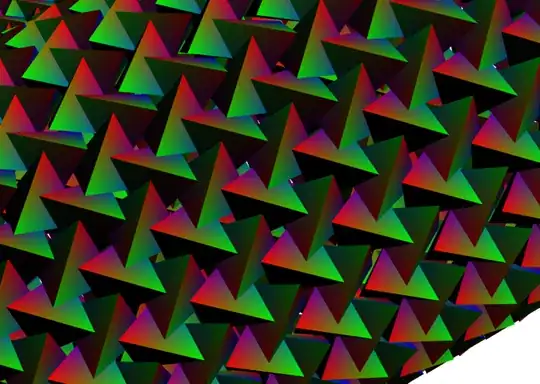

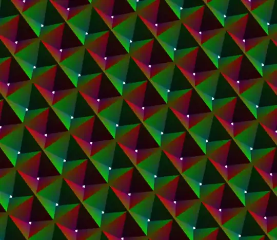

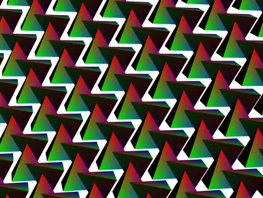

The construction has some flexibility. For instance, we can enlarge the tetrahedra to form a much tighter pattern.
hi

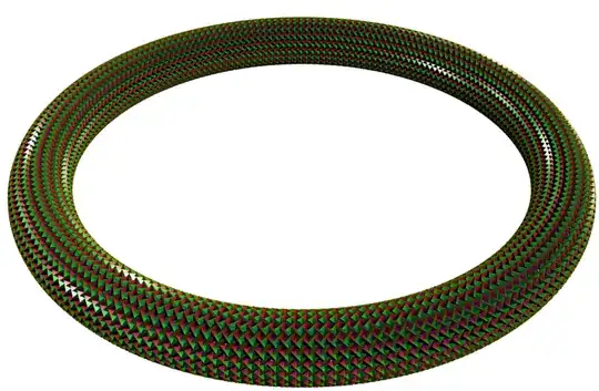

Miraculously, I found that the answer is still "yes"! The previously displayed arrangement of tetrahedral asteroids has some room for flexibility, and in particular this means that the "plane" formed by the tetrahedra can be given some curvature to form a compact manifold.
However, it is unclear if the asteroids can be wrapped into a sphere (a natural first candidate) while maintaining their delicate interlocking structure. Which is why I instead wrapped them into a torus!
torus
The monstrosity you see here is a stable asteroid cluster formed by $8000$ tetrahedra. For visual proof that this indeed works, here are photos of the "outer curvature" and the "inner curvature", respectively:
outer
inner
Neat! I can provide details on this construction upon request, though it should be fairly believable that such a construction cannot fail provided that the torus is large enough. Indeed, if the original "infinite" construction works, then surely it should still work after a small perturbation. So the toroidal arrangement should also work provided that, locally, the curvature is negligible enough to induce only small perturbations. Thanks to the choice of using a torus, the interlocking structure can be preserved for sure.
