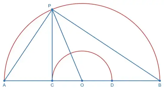

Let $\overline {\text {AC}} = {x}_{1}$ and $\overline {\text {AD}} = \overline {\text {BC}} = {x}_{2}$. Then $\overline {\text {OP}} = \overline {\text {OA}} = \overline {\text {OB}} = a = \left( {x}_{1} + {x}_{2} \right) / \, 2$ and $\overline {\text {CP}} = g = \sqrt {{x}_{1} {x}_{2}}$, so $\overline {\text {OC}} = \sqrt {{a}^{2} - {g}^{2}}$. Think of $\text {A}$ as the origin.
