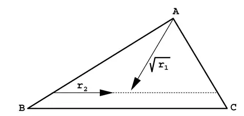

A direct way to get a uniform distribution of points in a triangle $ABC$ is by using this barycentrical expression :
$$M=(1-\sqrt{r_{1}})A+(\sqrt{r_{1}}r_{2})B+\sqrt{r_{1}}(1-r_{2})C\tag{1}$$
where $r_1,r_2,r_3$ are uniformly distributed on $[0,1]$.
Otherwise said, as a two-step barycentration :
$$M=(1-\sqrt{r_{1}})A+\sqrt{r_{1}}\color{red}{\left[r_{2}B+(1-r_{2})C\right]}\tag{2}$$
The earliest version I have found of formulas (1)/(2) is in this interesting ACM 2002 article : see its p. 814 with a graphical "heuristic proof" of formula (2) above given p. 815 that I reproduce here :
Formulas (1)/(2) are mentionned and established here.
