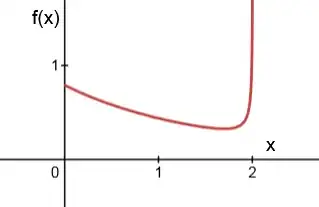

Distribution of $a$
Here I derive $f(x)$, the density function of $a$, which is the same as the density function of $b$ and $c$. However, I do not know if this is helpful, because $a,b,c$ are not independent.
Suppose the first chosen random point on the circle is $O$, and $a$ is the length of the side immediately anticlockwise from $O$.
$a>x$ if all the other chosen points are on the major arc subtended by the red line segment, and the other chosen points are not all on the minor arc subtended by the green line segment.
$\theta=\arcsin \frac{x}{2}$
$\begin{align} P(a<x)&=1-P(a>x)\\ &=1-\left(\left(1-\frac{1}{\pi}\arcsin\frac{x}{2}\right)^5-\left(\frac{1}{\pi}\arcsin\frac{x}{2}\right)^5\right) \end{align}$
$\begin{align} f(x)&=\frac{d}{dx}P(a<x)\\ &=\frac{5}{\pi\sqrt{4-x^2}}\left(\left(1-\frac{1}{\pi}\arcsin\frac{x}{2}\right)^4+\left(\frac{1}{\pi}\arcsin\frac{x}{2}\right)^4\right)\\ \end{align}$
I checked that $\int_0^2f(x)\mathrm dx=1$.

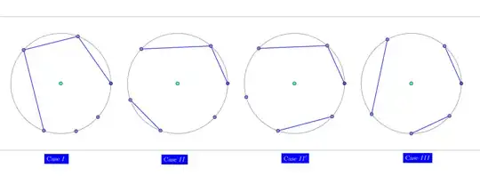

Here are some pictures of making a choice of three sides as a set, when a configuration of six points $A\in C_0(6)$ is fixed.
Let us fix ideas, and consider the case I. By rotational symmetry, we can place the component $A_0$ of a $6$-tulple $A$ in $0$, then integrate on the piece $\Delta(5)$ of all $x=(x_1,x_2,x_3,x_4,x_5)\in[0,2\pi)^5$ with $ 0\le x_1\le x_2\le x_3\le x_4\le x_5\le 2\pi $, which determine the positions of $A_1,A_2,A_3,A_4,A_5)$ on the circumerence. The volume of this space of configurations is $(2\pi)^5/5!$, the volume of the $5$-dimensional simplex with size $(2\pi)$.
