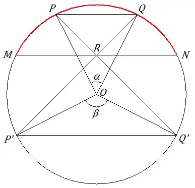

A proof from pure geometry
On a unit circle with centre $O$, draw parallel chords $PQ$ and $P'Q'$ such that $PQ'\perp P'Q$. Chord $MN$ is parallel to $PQ$ and passes through $R$, the intersection of $PQ'$ and $P'Q$. Minor arc $MN$ is colored red. $\alpha=\angle POQ$ and $\beta=\angle P'OQ'$, where $\alpha$ and $\beta$ are convex.
We use the fact that, for a triangle with side lengths $a,b,c$ inscribed in a unit circle, $\text{area}=\frac{abc}{4}$. (Proof: $\frac12\angle AOB=\angle ACB$ so $\text{area}=\frac12ab\sin C=\frac12ab\left(\frac12c\right)$.)
$\therefore P(ab<c)=P\left(\frac{abc}{4}<\frac{c^2}{4}\right)=P\left(\text{area}<\frac{c^2}{4}\right)$
Let $P$ be the first chosen vertex of the triangle, and $Q$ the second chosen vertex. Let $PQ=c$. If $ab\color{red}{<}c$, the third chosen point must lie on the red arc. (This is because the inscribed triangle's area must be smaller than $\frac{c^2}{4}$, which is the area of $\triangle PQR$.)
So $P(ab\color{red}{<}c)$ is the proportion of the red arc length to the circumference of the circle, averaged as $\color{red}{\alpha}$ goes from $0^\circ$ to $180^\circ$.
Now instead let $P'$ be the first chosen vertex, and $Q'$ the second chosen vertex. Let $P'Q'=c$. If $ab\color{red}{>}c$, the third chosen point must lie on the red arc. (This is because the inscribed triangle's area must be greater than $\frac{c^2}{4}$, which is the area of $\triangle P'Q'R$.)
So $P(ab\color{red}{>}c)$ is the proportion of the red arc length to the circumference of the circle, averaged as $\color{red}{\beta}$ goes from $0$ to $180^\circ$, or by symmetry, as $\color{red}{\beta}$ goes from $180^\circ$ to $0^\circ$.
Obviously, $\alpha+\beta=180^\circ$ ($\angle POP'=2\times \angle PQ'P=90^\circ$).
Therefore the red arc length averaged as $\alpha$ goes from $0^\circ$ to $180^\circ$, is exactly the same as the red arc length averaged as $\beta$ goes from $180^\circ$ to $0^\circ$.
Therefore $P(ab<c)=P(ab>c)$. And since $P(ab<c)+P(ab>c)=1$, we have $P(ab>c)=\frac12.$
