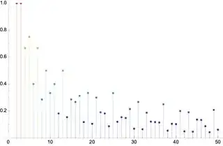

For example, when graphing $E(b)$ you get the following:
E(b) for b between 2 and 50
We can see that bases $2$ and $3$ have a $100$% digit-sum trick effectiveness, meaning that the digit-sum trick works for all numbers less than their respective bases.
Another thing to notice is that we occasionally get spikes in the graph. Some of these can be attributed to highly composite numbers which are numbers $n$ that satisfy $\sigma_0(n) \ge \sigma_0(k)$ for all $k \le n$. The spike on $E(25)$ is because $24$ is a highly composite number, and the spike at $E(13)$ is because $12$ is a highly composite number. Thus, if you pick a base one more than a highly composite number you'll get several working digit-sum divisibility tricks.
We can also explain most "dips" in the graph for a similar reason. Since $\sigma_0(p) =2$ for any prime $p$, then for bases one more than a prime you'll get efficiency $E(p+1) = \frac{2}{p}$ which can get arbitrarily small for larger and larger primes.

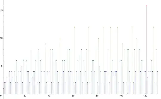

Here's a graph of just $\sigma_0(b-1)$:
Graph of \sigma_0(b-1)
