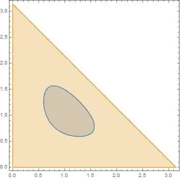

Let the point $C$ fixed on the circle, the points $A$ and $B$ move independently and uniformly over the cirle, then the two angles $(A,B)$ (by abusing the notation, angle are also denoted by the letters $A$ and $B$) independent and uniformly distributed over the area $\left[0,\pi\right]^2 \cap\{A+B \le\pi \}$.
Here is the region $\Omega$ that satisfies $(1)$, plotted with Mathematica
 RegionPlot[{Sqrt[(1 - Cos[A]^2) (1 - Cos[B]^2)] >=
 Cos[A]*Cos[B] - Cos[A] - Cos[B] + Sqrt[2], A + B <= Pi}, {A, 0,
 Pi}, {B, 0, Pi}]
From the graph, we observe that $(A,B)$ that satisfies $(1)$ satisfies automatically the condition $A+B \le \pi$. So, it suffices to solve $(1)$ with the constraint $ \{0\le A \le \pi\} \cap \{0\le B \le \pi\}$.

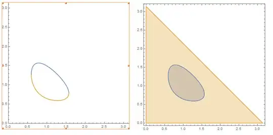

We deduce then $$\color{red}{\Omega = \{(A,B)| (A,B)\in \left[\arccos(2\sqrt{2}-2),\frac{\pi}{2} \right] \times [\arccos(f_2(A),\arccos(f_1(A) ] \}}$$
Let us check again graphically:
Plot[{ArcCos[f1[A]], ArcCos[f2[A]]}, {A, ArcCos[2 (-1 + Sqrt[2])],
\[Pi]/2},PlotRange -> {{0, Pi}, {0, Pi}}, AspectRatio -> 1]
we obtain exactly the same graph as above
The probability is finally calculated with a single integral:
$$\color{red}{P = \frac{2}{\pi^2} \int_{\arccos(2\sqrt{2}-2)}^{\frac{\pi}{2}}\left( \arccos(f_1(A)-\arccos(f_2(A) \right)dA \approx 0.1299825992533093}$$
2/Pi^2*NIntegrate[ArcCos[f1[A]]-ArcCos[f2[A]],{A,ArcCos[2(-1 +Sqrt[2])],\[Pi]/2}]

  • Are you sure the distribution of angles $A$ and $B$ in $[0,\pi]$ is uniform? I guess that the probability density function should be increasing, not uniform. (My guess is supported by a quick simulation.) This would make a slight difference in the final answer. – Dan Jan 29 '24 at 00:37
  • @Dan Yes, the distribution of the angles $\angle A$ (aka: $\angle CAB$) and $\angle B$ (aka: $\angle CBA$) is uniformly in $[0,\pi]$. If we make the point $C$ fixed on the circle, as the point $B$ is uniformly distributed on the cirle centered at $O$, the angle $\angle COB$ is uniformly distributed in $[0,2\pi]$. And because $\angle COB = 2\angle CAB$ ($=2\angle A$), we deduce then the angles $\angle A$ is uniformly distributed in $[0,\pi]$. – NN2 Jan 29 '24 at 00:50
  • I get it now. If we draw a graph with an $A$-axis and a $B$-axis, the combinations of $A$ and $B$ will uniformly fill the right triangle with vertices $(0,0), (0,\pi), (\pi,0)$ on this graph (as @Sangchul's answer describes). But if we look only at say $A$, the distribution of $A$ is not uniform in $[0,\pi]$; the density function of $A$ is decreasing (in my previous comment, I mistakenly wrote "increasing"). – Dan Jan 29 '24 at 01:28
  • @Dan Yes, and with the constraint $0\le A + B \le \pi$ (as $ABC$ is a triangle), the two angles $(A,B)$ becomes uniformly distributed on the triangle $(0,0), (0,\pi)$ and $(\pi, 0)$. – NN2 Jan 29 '24 at 01:32

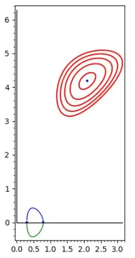

Edit : My first intention was to propose a graphical representation.
Meanwhile, I have discovered a solution (which has common points with the solution by NN2 but with a distinct path, and slightly simpler) :
Let $$\begin{cases}k&:=&\tfrac12(1-\sqrt{2})\approx -0.2071\\x_0&:=&\operatorname{asin}(\tfrac12(2-\sqrt{2}))\approx 0.2973\\x_1&:=&\operatorname{asin}(\tfrac12 \sqrt{2})=\tfrac{\pi}{4}\approx 0.7854\end{cases}.$$
and
$$f(x):=\operatorname{asin} \left(\frac{k}{\sin(x)}-\sin(x)\right)+\frac{\pi}{2}\tag{0}$$
The looked for probability can be given the simple expression :
$$\frac{8}{\pi^2}\int_{x_0}^{x_1} f(x) dx\approx 0.1299825992\tag{*}$$
Proof of (*) :
WLOG, we can assume that one of the points is $A=(1,0)$ and the two others are $B=(\cos u, \sin u)$, $C=(\cos v, \sin v)$.
We can assume (see figure below) that $u \in [0, \pi]$, and $v \in [\pi,2 \pi]$. indeed, cases where $\pi < v <u$ or $u<v<\pi$ do not contribute to the region of plane $(u,v)$ we are interested in.
Using the formula given by @kabenyuk
$$r/R=\cos A+\cos B + \cos C-1$$
which becomes, with $R=1$ and level line $r_0=\sqrt{2}-1$ :
$$r=\cos((v-u)/2)+\cos((2 \pi - v)/2)+\cos(u/2)-1 \ge r_0$$
Otherwise said, we are interested in level line
$$r=r(u,v)=(\cos(u/2)-\cos(v/2))+(\cos((u-v)/2)-1)=r_0\tag{**}$$
Therefore, in a $(u,v)$ coordinate system (see figure), region (R) is the interior of the largest of the represented level lines of the function described by $(**)$ for $r$ ranging from $r=r_0$ to its extreme value $r_{max}=\tfrac12$, achieved in the single point with coordinates $(u,v)=(\tfrac{2\pi}{3},\tfrac{4\pi}{3})$, which, in a natural way, corresponds to the equilateral triangle case.
But (**) can be written :
$$-2 \sin\left(\tfrac14(u+v)\right)\sin\left(\tfrac14(u-v)\right)-2\left(\sin\left(\tfrac14(u-v)\right)\right)^2=\sqrt{2}-1\tag{***}$$
Consider now the following change of variable which can be interpreted (in a reverse way) as a linear transformation $(L)$ :
$$\begin{cases}a&=&\tfrac14(u-v)\\b&=&\tfrac14(u+v)\end{cases},$$
allowing to write (***) under the factorized form :
$$-\sin a (\sin a + \sin b) = k \ \ \ \text{with} \ k = \frac{r_0}{2}=\frac{\sqrt{2}-1}{2}$$
$$\sin b = \sin a - \frac{k}{\sin a}$$
which gives (in order for variable $b$ to take positive values) :
$$b=\operatorname{asin} \left(\frac{k}{\sin(a)}-\sin(a)\right)+\frac{\pi}{2}$$
We have obtained in this way function $f$ given at the beginning in (0). With its twin function $-f$, the union of their curves, represented in blue and green resp. in figure 1, can clearly be interpreted as the image of the initial level curve by transformation (L). Therefore we have to multiply the integral of $f$ by $2$ (in order to account of $-f$), then by $8$, in order to recover the area of the initial shape. Why $8$ ? Because it is the inverse jacobian of linear transformation (L) (whose determinant is $1/8$). Therefore, we must multiply the area between the blue curve and the $u$-axis by $16$ in order to retrieve the initial area.
Now, how can we express the probability out of this relative area ? The area value obtained just above must be divided by the total area $2\pi^2$ (enclosed by black axes in the figure) under the assumptions of uniform distribution of angles $u,v$, ending the proof of formula (*).
Have a look at the SAGE program below giving some complementary information.
Fig. 1 : Representation in the $(u,v)$ plane. The small oval shape is the image of the big one (the largest of level lines) by linear transform $(L)$.
Remark : The identity about $r/R$ recalled by kabenyuk could have been replaced by the equivalent formula :
$$r/R=4 \sin(A/2)\sin(B/2)\sin(C/2)$$
SAGE program :

  • I'm getting $\frac{\left((x_1-x_0)\frac{\pi}{2}-I\right)}{8\pi^2}\approx 0.01739$. – Dan Jan 29 '24 at 00:48
  • Sorry, it is $8\frac{\left((x_1-x_0)\frac{\pi}{2}+I\right)}{\pi^2}$ with $I=\int_{x_0}^{x_1} asin(k/\sin(x)-\sin(x))dx$ – Jean Marie Jan 29 '24 at 08:46
  • Sorry, but now I'm getting $\frac{8}{\pi^2}I\approx 1.11307$. – Dan Jan 29 '24 at 12:57
  • [Sorry again : It must be because I have taken $(x_1-x_0)$instead of its opposite but have you included this term in your calculation ?] But in fact, as I have just completely re-written my answer with justifications, it is probably better to restart from the simpler expression I just gave for the probability. – Jean Marie Jan 29 '24 at 13:44
  • Thanks. Yes, it (*) is a relatively simple expression for the probability. – Dan Jan 29 '24 at 14:32

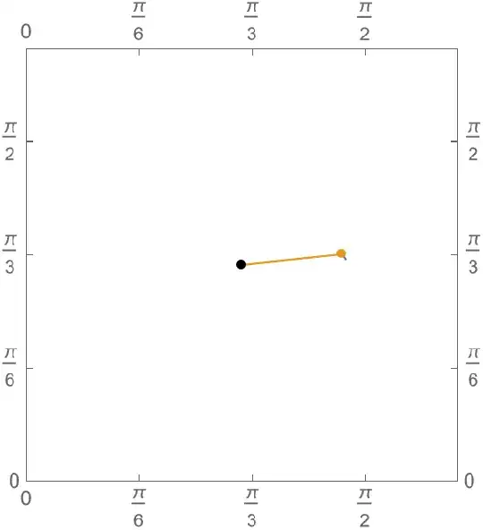

Numerical Method Used. Here is the outline of the numerical technique I used to approximate $\mathbf{P}(d<r)$.
First, let $\mathcal{C}$ denote the contour $\cos x + \cos y = \cos(x+y) + \sqrt{2}$ in the region $[0, \pi]^2$. As in @NN2's answer, we can visually confirm that $\mathcal{C}$ is a simple closed curve. Now,
  • Fix an point $(x_0, y_0)$ enclosed by $\mathcal{C}$. For example, we may choose $(x_0, y_0) = (1, 1)$ or $(x_0, y_0) = (\frac{\pi}{3}, \frac{\pi}{3})$.
  • Parametrize $\mathcal{C}$ by $(x, y) = (x_0, y_0) + f(t) (\cos t, \sin t)$ for $t \in \mathbb{R}/2\pi\mathbb{Z}$.
Parametrization
Then the area enclosed by $\mathcal{C}$ can be computed by the integral
$$ \text{Area} = \int_{0}^{2\pi} \frac{f(t)^2}{2} \, \mathrm{d}t. $$
Although computing the value of $f(t)$ is expensive, requiring some optimization techniques, it turns out that $\text{Area}$ is very well approximated by a simple "right-endpoint approximation"
$$ \text{Area} \approx \sum_{k=1}^{N} \frac{f(2\pi k/N)^2}{2} \cdot \frac{2\pi}{N} \tag{*} $$
