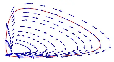

I want to add a perspective that does not use volumes to consider integrals.
An integral is a solution to a differential equation. Differential equations can be visualized by their corresponding vector field and the integral can be considered as a flow through this vector field. There are many possible flows through a vector field, all depending on where we start. The constant $C$ can be regarded as the parameter that determines the starting point. predator-prey system
Marius S.L.
