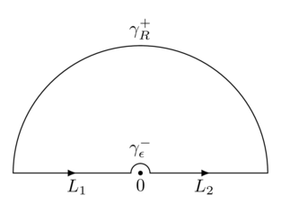

Method 1. Let me demonstrate a method that only relies on contour integration. Consider the contour $\mathcal{C} = \mathcal{C}_{R,\epsilon}$ of the form
contour
where $\gamma_R^+$ (resp. $\gamma^-_{\epsilon}$) is the CCW-oriented (resp. CW-oriented) upper semicircular arc of radius $R$ (resp. $\epsilon$). Then by the residue theorem,
\begin{align*} 0 &= \oint_{\mathcal{C}} \frac{e^{ipz} - e^{iqz}}{z^2} \, \mathrm{d}z \\ &= \int_{L_1 \cup L_2} \frac{e^{ipx} - e^{iqx}}{x^2} \, \mathrm{d}x + \int_{\gamma^+_{R}} \frac{e^{ipz} - e^{iqz}}{z^2} \, \mathrm{d}z + \int_{\gamma^-_{\epsilon}} \frac{e^{ipz} - e^{iqz}}{z^2} \, \mathrm{d}z. \end{align*}

which converges to the OP's integral as $R \to \infty$ and $\epsilon \to 0^+$. For the second integral, note that
$$ \left| \int_{\gamma^+_{R}} \frac{e^{ipz} - e^{iqz}}{z^2} \, \mathrm{d}z \right| \leq \int_{\gamma^+_{R}} \frac{|e^{ipz} - e^{iqz}|}{|z|^2} \, |\mathrm{d}z| \leq \int_{\gamma^+_{R}} \frac{2}{R^2} \, |\mathrm{d}z| = \frac{2\pi}{R} \to 0 $$
as $R \to \infty$. Hence the integral vanishes in the limit. Finally, noting that $e^z = 1 + z + \mathcal{O}(z^2)$ as $z \to 0$,
\begin{align*} \int_{\gamma^-_{\epsilon}} \frac{e^{ipz} - e^{iqz}}{z^2} \, \mathrm{d}z &= \int_{\gamma^-_{\epsilon}} \biggl( \frac{i(p-q)}{z} + \mathcal{O}(1) \biggr) \, \mathrm{d}z \\ &= -\int_{0}^{\pi} \biggl( \frac{i(p-q)}{\epsilon e^{i\theta}} + \mathcal{O}(1) \biggr) \, (i\epsilon e^{i\theta}) \mathrm{d}\theta \\ &= (p-q)\pi + \mathcal{O}(\epsilon). \end{align*}
Hence this integral converges to $(p-q)\pi$ as $\epsilon \to 0^+$. Finally, combining all these computations together, we get
$$ 0 = \lim_{\substack{R \to \infty \\ \epsilon \to 0^+}} \oint_{\mathcal{C}} \frac{e^{ipz} - e^{iqz}}{z^2} \, \mathrm{d}z = \int_{-\infty}^{\infty} \frac{\cos(px) - \cos(qx)}{x^2} \, \mathrm{d}x + (p-q)\pi, $$
proving the desired equality.
