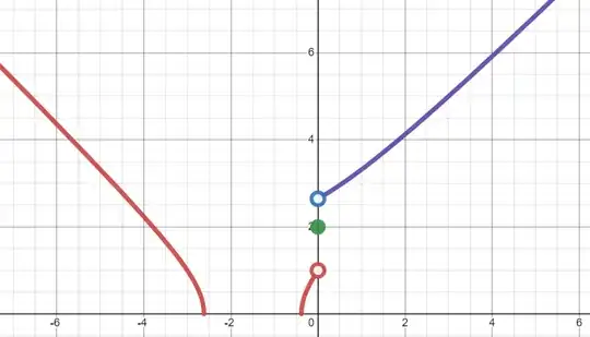

Thanks to the definition of $\newcommand{\sign}{\operatorname{sign}} \sign(x)$, then, your function - let's call it $f$ - technically has three pieces to be concerned with: $$ f(x) := \begin{cases} \sqrt{x^{2}+3x+7}, & \sign(x) =1 \text{; i.e., } x > 0 \\ \sqrt{x^{2}+3x+4}, & \sign(x) =0 \text{; i.e., } x = 0 \\ \sqrt{x^{2}+3x+1}, & \sign(x) =-1 \text{; i.e., } x < 0 \end{cases}$$
Graphically, $f$ has graph looking like this, each color representing one "case" above:
Notice how $f$ isn't even defined when $x^2+3x+1<0$, i.e. when $$ x \in \left( \frac{-3 - \sqrt 5}{2} , \frac{-3 + \sqrt 5}{2} \right) $$ so another concern of problems of this type to be wary of is when your derivative is defined for functions not even in the domain of $f$. I remember getting tripped on a problem of this type once, where we sought $f'$ for $f(x) := \ln(\ln(\sin(x)))$, the issue being $f$ isn't defined for any real number.
This isn't an issue for your problem, since your answer implicitly incorporates that, but I figured it worth noting in the general case.
Anyhow, the graph makes it clear that $f'$ doesn't exist at $x=0$: it isn't even continuous there. This can be seen from the limit definition, if you please. Essentially, you have
  • $\sqrt{x^2+3x+1} \xrightarrow{x \to 0^-} 1$ on the left branch
  • $\sqrt{x^2+3x+7} \xrightarrow{x \to 0^+} \sqrt 7$ on the right branch
  • $f(0)=2$
so the limit doesn't exist, you do not have continuity, and hence do not have differentiability.
