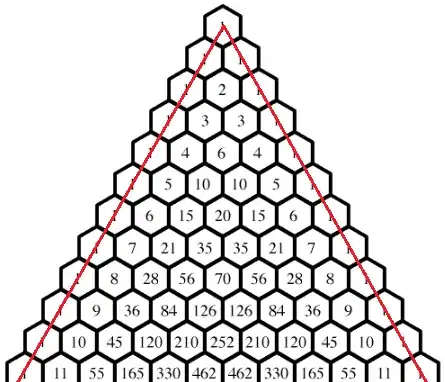

Consider Pascal's triangle without the $1$s.
Let $S$ be the sum of squares of reciprocals.
$$S=\frac{1}{2^2}+\frac{1}{3^2}+\frac{1}{3^2}+\frac{1}{4^2}+\frac{1}{6^2}+\frac{1}{4^2}+\frac{1}{5^2}+\cdots$$
Does $S$ have a closed form?

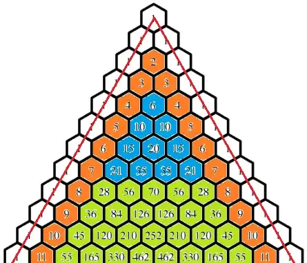

Showing that $1<S<2$
Consider the color-coded Pascal's triangle below. (The green and orange numbers extend below the diagram infinitely).
Let $T$ be the sum of reciprocals of the blue and green numbers. I found that $f(n)=\sum\limits_{k=2}^\infty\binom{n+k}{k}^{-1}=\frac{2}{n^2-1}$ for $n>1$ (source). Then $T=\sum\limits_{n=2}^\infty f(n)=\sum\limits_{n=2}^\infty \frac{2}{n^2-1}=\frac32$ by telescoping.
So the sum of reciprocals of the green numbers is $\frac32-\left(\frac16+\frac{2}{10}+\frac{2}{15}+\frac{1}{20}+\frac{2}{21}+\frac{2}{35}\right)=\frac{67}{84}$.
So the sum of squares of reciprocals of the green numbers is between $0$ and $\left(\frac{67}{84}\right)^2\approx 0.6361961451$.
Using the fact that $\sum\limits_{k=2}^\infty\frac{1}{k^2}=\frac{\pi^2}{6}-1$, the sum of squares of reciprocals of the orange and blue numbers is $2\left(\frac{\pi^2}{6}-1\right)-\left(\frac12\right)^2+\left(\frac{1}{6^2}+\frac{2}{10^2}+\frac{2}{15^2}+\frac{1}{20^2}+\frac{2}{21^2}+\frac{2}{35^2}\right)\approx 1.105202601$.
Therefore $1<S<2$.
