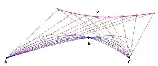

We can draw an infinite number of parabolas that pass through three given points $A$, $B$, $C$ (in that order). For each such parabola, we take the tangent lines at $A$ and $C$, and intersect them to get a point, $P$, which is called the "apex" of the parabola segment, in my business. What is the locus of this apex point $P$? I think it's a hyperbola that has the lines $AB$ and $BC$ as asymptotes.
Here's a picture. The pink curve is the locus that interests me.
parabolas
I believe the point $P$ is called the "polar point" of the chord $AC$, sometimes.
The answers to this question have some basic computations that might be useful.
The locus of the parabola vertex seems to be much more complicated. It is studied in this question. Given the complexity of the vertex locus, I think it's remarkable that the apex locus is so simple.
A parabola is, of course, a quadratic Bezier curve, and the apex point is its "middle" control point (if this helps).

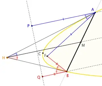

Some additional, relevant parabola geometry:
Parabola geometry
Here, $H$ is the "pole" of ("polar") $AB$, and $M$ is the midpoint of $AB$. Point $F$ is the focus of the parabola, and $PQ$ is its directrix (with $P$ and $Q$ respective projections of $A$ and $B$ onto that line). The focus-directrix definition of parabola tells us that $PA \cong FA$ and $QB\cong FB$; the reflection property implies that $HA$ and $HB$ bisect appropriate angles at $A$ and $B$.
Importantly, $HM$ determines the direction of the parabola's axis, so that $HM\parallel PA\parallel QB$. (One readily verifies this by studying the $y=x^2$ curve.) This tells us more about how $HM$ divides $\angle H$ (and also that $\angle AFC = 2\angle AHC$).
Fun facts: The parabola crosses $HM$ at the segment's midpoint; the tangent to the parabola at that point is parallel to $AB$. (Again, simply study the $y=x^2$ curve.)
All of this geometry ... and we haven't even considered point $C$! Constraining the parabola to meet $C$ ---that is, imposing the condition that $C$'s distance from $PQ$ equals $|FC|$--- is evidently what evokes the hyperbolic nature of the locus of $H$. So far, I have found this quite thorny to verify geometrically (and/or vectorially) in the general case; even transforming to the "nice" case (isosceles right $\triangle ABC$), the symbol crunching gets pretty intense ... and while a hyperbolic relation for $H$'s coordinates appears when the dust settles, the result remains unsatisfying. (Edit. A coordinate derivation appears below. The reason for the hyperbolic relation remains something of a mystery, however.)
Other notes

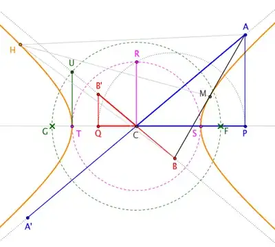

  • The hyperbola's transverse (conjugate) axis has length $\sqrt{a b}\cos\theta$ (respectively, $\sqrt{a b}\sin\theta$), where $a := |CA|$, $b := |CB|$, $\theta := \frac{1}{2}\angle ACB$. Thus, its focal radius is $\sqrt{ab}$.
  • (As shown in @Bubba's image, and mentioned his comment to @Achille's answer) $AB$ is tangent to the "other" branch of the hyperbola, with point of tangency $M$.
Here's an image showing the construction of the hyperbola (note that some point names have been re-purposed):
Hyperbola construction
We project $A$ and (the reflection in $C$ of $B$) $B^\prime$ to $P$ and $Q$ on the bisector of $\angle ACB$. Lifting $C$ into the (gray) semi-circle with diameter $PQ$ gives $R$, where $|CR|^2 = |CP||CQ| = a\cos\theta \cdot b\cos\theta$, so that $|CR| = \sqrt{ab}\cos\theta$. The (pink) circle about $C$ and through $R$ contains $S$ and $T$, the vertices of the hyperbola. Lifting $T$ into the asymptote $BB^\prime$ gives $U$, such that $|CU| = |CT|/\cos\theta = \sqrt{ab}$; and then the (green) circle about $C$ through $U$ contains the hyperbola's foci, $F$ and $G$.
Incidentally: From here, it's easy to verify that $M$ ---with coordinates $\left(\frac{a+b}{2}\cos\theta, \frac{a-b}{2}\sin\theta \right)$--- lies on the hyperbola $\frac{x^2}{ab\cos^2\theta}-\frac{y^2}{ab\sin^2\theta} = 1$, and (with a modicum of calculus) that $AB$ ---with slope $\frac{a+b}{a-b}\frac{\sin\theta}{\cos\theta}$ --- is tangent to the curve at that point.
More notes ...
Coordinates seem to suggest connections that I haven't quite grokked geometrically.
Take the original points to be $A(a \cos\theta, a\sin\theta)$, $B(b\cos\theta,-b\sin\theta)$, $C(0,0)$, with $H(h,k)$ the pole of polar $AB$. Midpoint $M$ of $AB$ has coordinates $$M = \left(\frac{a+b}{2}\cos\theta, \; \frac{a-b}{2} \sin\theta \right)$$
so that vector $\overrightarrow{MH}$ has components $$\overrightarrow{MH} = \left(h - \frac{a+b}{2}\cos\theta, \; k - \frac{a-b}{2} \sin\theta \right) =: (p, q)$$ that occur surprisingly-often in this analysis.
We can construct the focus $F$ of the parabola as follows: Lift the midpoints of $HA$ and $HB$ to points $A^\prime$ and $B^\prime$ on $MH$. By construction, $\triangle HAA^\prime$ is isosceles; since we've already noted that $\angle HAF \cong \angle MHA$, it follows that $\overleftrightarrow{AA^\prime}$ contains $F$; as does $\overleftrightarrow{BB^\prime}$, so that the focus is the intersection of these lines and has coordinates $$F = \frac{1}{2\;(p^2+q^2)}\left( \; 2 h k\;\left( q, p \right) + ( h^2 - k^2 - a b ) \;\left( p, -q \right) \; \right) $$
To construct directrix $\overleftrightarrow{PQ}$, recall that the midpoint of $HM$ lies on the parabola, and that the tangent line at that point is parallel to $AB$. Reflecting $F$ across that tangent line gives a point on $PQ$; and we know that $PQ \perp HM$, so $$\overleftrightarrow{PQ} : \quad 2 x p + 2 y q = h^2 + k^2 - a b \cos 2\theta$$
The squared distances from $C$ (the origin) to the focus and directrix are then $$|CF|^2 = \frac{ \left( h^2 - k^2 - a b \right)^2 + 4 h^2 k^2}{4\;(p^2+q^2)} \qquad\qquad |C,\;\overleftrightarrow{PQ}|^2 = \frac{\left( h^2 + k^2 - a b \cos 2\theta \right)^2}{4\;( p^2+q^2 )}$$
For $C$ to lie on the parabola, these values must match; therefore, $$4 h^2 \sin^2\theta - 4 k^2 \cos^2\theta = a b \sin^2 2\theta \quad \to \quad \frac{h^2}{a b \cos^2\theta} - \frac{k^2}{a b\sin^2\theta} = 1$$ as expected.
The trick to really understanding this situation, then, is properly interpreting how the geometry contributes to the coordinate formulas ... in particular, the formula for focus $F$. Of course, $(q,p)$ and $(p,-q)$ are simply transformations of $(p,q) = \overrightarrow{MH}$, and $p^2+q^2$ is the squared length of that vector; no mystery there. But what are the (very hyperbola-esque) multipliers $2hk$ and $h^2-k^2-a b$ trying to tell us? I don't know ...

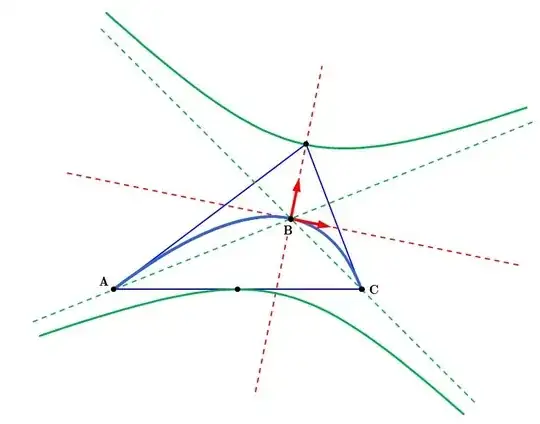

Here is a picture that illustrates the situation. The red dashed lines are the axes of symmetry of the hyperbola, and the green dashed lines are its asymptotes. You can see how one of the axes of symmetry is normal to both the parabola (at $B$) and the hyperbola (at its vertex).
