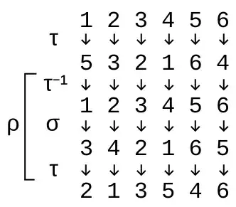

Arturo's answer is excellent, but the example from it makes little sense if you're thinking in two-line notation:
two-line

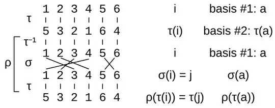

Let's remove the arrow heads (because these are bijections) and "shuffle" as a semantically different kind of operation than relabeling:
with-shuffle

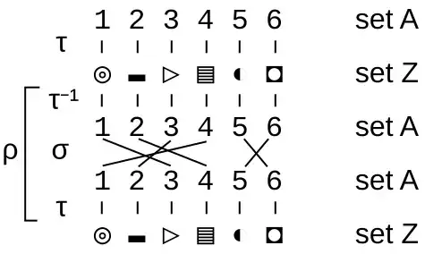

Alon's answer suggested thinking in separate sets, which we can emphasize with separate symbols:
permute-sets
