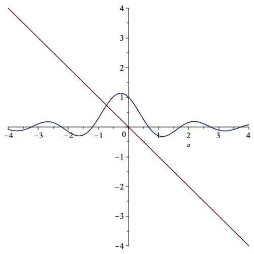

There are many many of these sequences. Just some fidding produced this example...
$$ a_k = \frac{(-1)^k(2k+1)c}{k(k+1)} = (-1)^k\left(\frac{c}{k}+\frac{c}{k+1}\right) $$ where $c$ is a certain constant. I computed (using Maple) $$ \prod_{k=1}^\infty(1+a_k) = \frac{2}{c\pi} \sin\left(\frac{\pi(1+2c+\sqrt{1+4c^2})}{4}\right) \sin\left(\frac{\pi(1+2c-\sqrt{1+4c^2})}{4}\right) \\ \sum_{k=1}^\infty a_k = -c $$ A
There is a value $c$ where these are equal ... numerically $$ c \approx -0.73194187299064067002 $$
