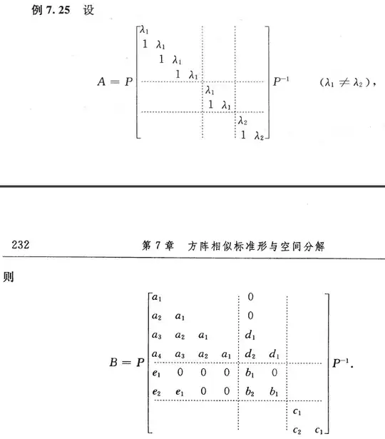

There is actually a sufficient and necessary condition for $M_n(\mathbb{C})$:
Let $J$ be the Jordan canonical form of a complex matrix $A$, i.e., $$ A=PJP^{-1}=P\mathrm{diag}(J_1,\cdots,J_s)P^{-1} $$ where $$ J_i=\lambda_iI+N_i=\left(\begin{matrix} \lambda_i & & &\\ 1 & \ddots & & \\ & \ddots & \ddots & \\ & & 1 & \lambda_i \end{matrix}\right). $$ Then the matrices commutable with $A$ have the form of $$ B=PB_1P^{-1}=P(B_{ij})P^{-1} $$ where $B_1=(B_{ij})$ has the same blocking as $J$, and $$ B_{ij}=\begin{cases} 0 &\mbox{if } \lambda_i\ne\lambda_j\\ \mbox{a }\unicode{x201C}\mbox{lower-triangle-layered matrix''} & \mbox{if } \lambda_i=\lambda_j \end{cases} $$
The reference is my textbook of linear algebra, though not in English. Here is an example in the book:
The main part in the proof is to compare the corresponding entries in both sides of the equation $N_iB_{ij}=B_{ij}N_j$ when $\lambda_i=\lambda_j$.
