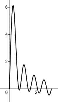

Consider $f(x)=\sum\limits_{k=1}^n\sin (kx), 0\le x \le \pi$.
Here is the graph of $y=f(x)$ for $n=8$.
I noticed that, as $n\to\infty$, the maximum value of $\frac1n f(x)$ seems to approach a limit of approximately $0.7246$.
What is $\lim\limits_{n\to\infty}\frac1n \left(\text{maximum value of }\sum\limits_{k=1}^n\sin (kx)\right)$ ?

I tried to find the first turning point to the right of the $y$-axis, without success.
I don't know if this helps, but I have found the roots of $f(x)$, and shown that there is exactly one turning point between neighboring roots.

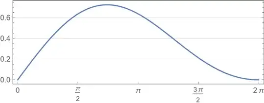

Below is the graph of $\frac{1-\cos t}{t}$ for $t \in [0, 2\pi]$.
Graph of the limiting function
Although the maximum point $t^*$ of this function is unlikely to be given by a closed form, it is easy to locate it numerically, yielding
$$ t^* \approx 2.3311223704144226136, \qquad M = \frac{1-\cos t^*}{t^*} \approx 0.7246113537767084758. $$
