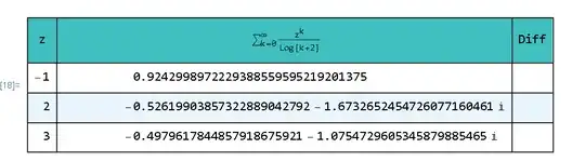

some values.. enter image description here
with z=1 agree with your calculation pole in z=1 and the rest analitic continuation
