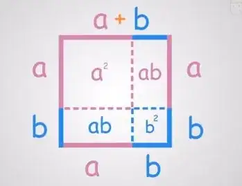

Note that $\sqrt{x} + \sqrt{y} = \sqrt{x+y} \iff (\sqrt{x} + \sqrt{y})^2 = (\sqrt{x+y})^2 \iff (\sqrt{x} + \sqrt{y})^2 = x + y$.
In order to intuitively understand it, let's substitute $$ a = \sqrt{x}, b = \sqrt{y}$$
So your question is kind of equivalent to $ (a+b)^2 = a^2 + b^2$ ?
Let's try to understand this with the area of a square:
Clearly there is more area in $(a+b)^2$ than in $a^2 + b^2$.
Specifically the difference is $2ab$, i.e. $2\sqrt{x}\sqrt{y}$, a difference which is significant in most cases.
