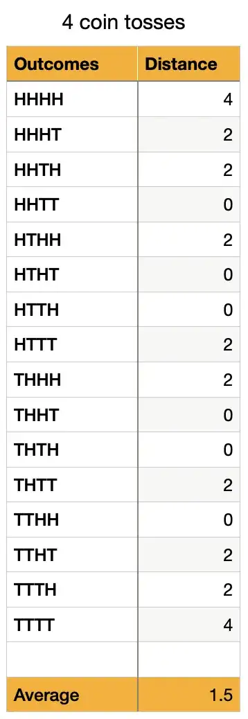

Here's a table with all the possible outcomes for just 4 coin tosses, along with their average distance from the start:
outcomes from 4 coin tosses
As you can see, if you toss a coin 4 times and take 1 step north on heads and 1 step south on tails, on average you'll end up 1.5 steps from the start.
