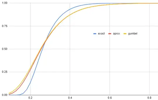

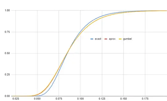

To add to the accepted (and exact) answer. For large $n$, an asymptotic can be developed, assuming the distances can be approximated as $m=n+1$ exponential iid variables of mean $1/m$.
Then, letting $M$ be the maximum of those variables, we get
$$\begin{align} P(M\le x) &= (1- e^{-m x})^m \tag 1\\ &\approx \exp(-m\, e^{-mx}) \tag2 \end{align} $$
Here's a comparison for $n=10$, the line "approx" corresponds to $(1)$ and "gumbel" to $(2)$.
comparison for N=10
For $n=50$:
comparison for N=50
