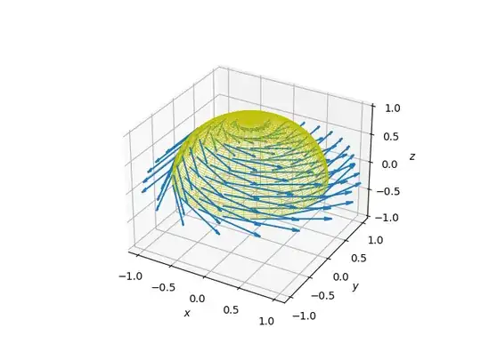

  • Alternatively one can view the RHS of, say, (4) as the dot product $\boldsymbol{t}\cdot\boldsymbol{F}$ where $$\tag{5} \boldsymbol{t}=\begin{pmatrix}-n_2\\n_1\\0\end{pmatrix}\,. $$ This is a vector field tangential to the surface. See image below.
  • For a unit sphere the unit normal is $$ \begin{pmatrix}x\\y\\z\end{pmatrix} $$ and therefore the tangential field (5) is $$ \boldsymbol{t}=\begin{pmatrix}-y\\x\\0\end{pmatrix}\,. $$ Its curl is constant and points along the $z$-axis: $$ \nabla\times \boldsymbol{t}=\begin{pmatrix}2\\0\\0\end{pmatrix}\,. $$
  • It should be intuitively clear that the $z$-component of the curl of $\mathbf{F}$ is the surface integral (4) of the dot product $\boldsymbol{t}\cdot\boldsymbol{F}\,.$ The same reasoning applies to (2) and (3).
Image of the tangential field $\boldsymbol{t}\,:$ enter image description here
