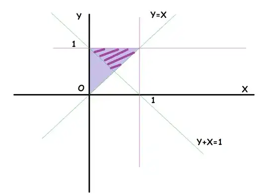

(1) Shortest 3 Consecutive Pieces :
Let the Stick be broken & the Pieces arranged by Size.
Take the Shortest 3 Consecutive Pieces $(X,Y,Z)$ where $X \le Y \le Z$.
We want $X+Y \ge Z$
We can scale these ( by Dividing throughout by $Z$ ) to get $(x=X/Z,y=Y/Z,z=Z/Z=1)$
What we now want is :
$x+y \ge 1 \tag{C1}$
where
$x \le y \le 1 \tag{C2}$
STICKS
OBSERVATION 1 : In Case , we have the additional Criteria :
$X+Y+Z = Constant \tag{??C3??}$
then it is equivalent to this Case , where Probability is $1/4$ , though that Criteria is not valid here in the limiting Case.
That Shaded Area ( larger triangle ) is satisfying (2) , while that Highlighted Area ( Smaller triangle ) satisfies (1) , hence that will give the necessary Probability $P=0.25/0.5=0.5$ , matching the Simulations.
OBSERVATION 2 : Simulation Probability is moving from the Initial Case where we have the additional Criteria (C3) to the limiting Case where that Criteria (C3) is irrelevant. The Simulation is moving from $0.25$ ( $n$ close to $3$ ) to $0.5$ ( $n$ very large ) gradually.

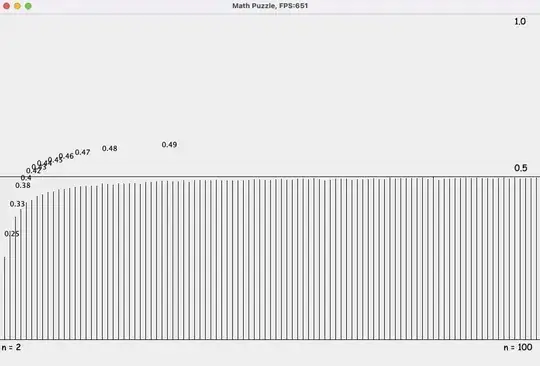

Upon running more simulations, I agree with the comments. The probability tends towards $0.5$, as shown in the result graph below
<span class=$n = 100$" />
This simulation consisted of $10000 \cdot 10000$ (nested) iterations for every $n$; $\, 2 \le n \le 100$.

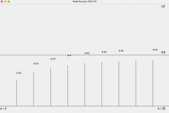

The interesting thing to analyse, is the first $10$ values for $n$; $\, 2 \le n \le 10$.
<span class=$n = 10$" />

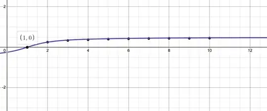

This is where the most change occurs in probability, and funnily enough can be near perfectly mapped by the density function $$f(x) = \dfrac{1}{\pi}\cdot\tan^{-1}{(n - 1)}$$
Desmos analysis
Observe, it nicely obeys our convergence of $0.5$, as $n \to \infty$. However, I am unsure what other useful information this function gives us, other than the analytic continuation of the experiment over $\mathbb{R}$.
