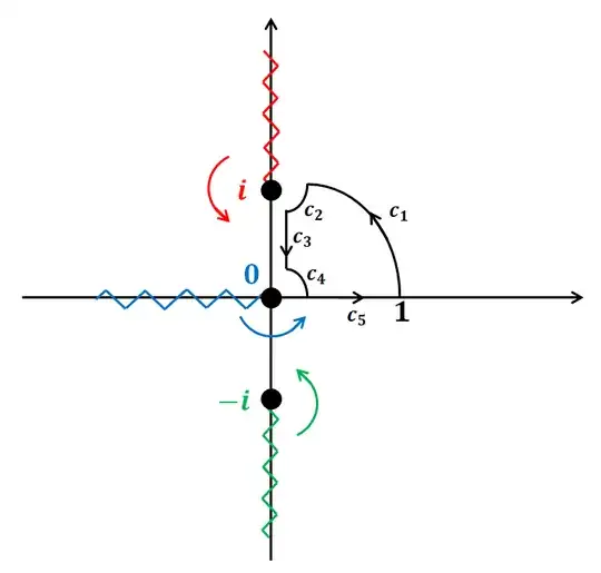

We use the following contour:
take the branch cut as shown in the figure.
$$\arg(z-i)\in (-\pi,\pi],~~~\arg(z)\in (-\pi,\pi],~~~\arg(z+i)\in (-\pi,\pi]$$

$$\frac1{2^a i}\int_{C_1}\frac{f(z)}z~dz+\frac1{2^a i}\int_{C_2}\frac{f(z)}z~dz+\cdots+\frac1{2^a i}\int_{C_5}\frac{f(z)}z~dz=0$$
The integral vanishes on $C_2$. On $C_4$, we have
$$\frac1{2^a i}\int_{C_4}\frac{f(z)}z~dz=\frac1{2^a i}\cdot \frac{-2\pi i}4 Res(z=0)=-\frac{\pi}{2^{a+1}}$$ On $C_3$, we have $\arg f=0+0=0$, $z=r e^{i\frac\pi2}$
$$\frac1{2^a i}\int_{C_3}\frac{f(z)}z~dz=\frac1{2^a i}\int_1^0\frac{(1-r^2)^a}{r}~dr=\frac i{2^a}\int_0^1\frac{(1-r^2)^a}{r}~dr$$
enter image description here On $C_5$, we have $\arg f=\beta+(-\beta)=0$, $z=r e^{i\cdot0}$

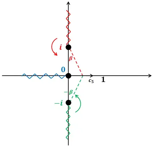

$$\frac1{2^a i}\int_{C_5}\frac{f(z)}z~dz=\frac1{2^a i}\int_0^1\frac{(1+r^2)^a}{r}~dr=-\frac i{2^a}\int_0^1\frac{(1+r^2)^a}{r}~dr$$

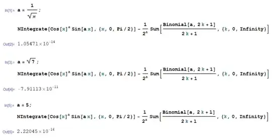

$$\boxed{\int_{0}^{\pi/2} \cos^a (x) \sin (a x) \ dx=\frac1{2^{a}}\sum_{m=0}^\infty\frac1{2m+1}\binom{a}{2m+1}}$$
Numerically verified by Wolfram as below,

  • What made you choose all the arguments to be in the interval $(-\pi, \pi]$? If the two branch cuts lie on the imaginary axis where one goes upward and one goes downward, shouldn't $-\pi/2 < \text{arg}(z+i) \leq 3\pi/2$ and $-3\pi/2 \leq \text{arg}(z-i) < \pi/2$? – Accelerator Jun 07 '23 at 09:23
  • The choice of argument angle is arbitrary, I did this way since I want the combined argument angle for function $f$ on $C_3$ and $C_5$ to be zero. @Accelerator – MathFail Jun 07 '23 at 09:28
