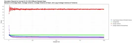

To test this idea, I tried to perform the following experiment using the R programming language: For a Normal Distribution with (10,10) - random samples for different sizes are taken and the sample mean, sample variance, variance of the sample mean and variance of the sample variance are calculated. This process is then repeated many times.

summary_stats <- results_df %>% group_by(sample_size) %>% summarise(mean_sample_mean = mean(sample_mean), mean_sample_variance = mean(sample_variance), mean_sample_variance_of_mean = mean(sample_variance_of_mean), mean_sample_variance_of_variance = log(mean(sample_variance_of_variance)))
graph <- ggplot(summary_stats, aes(x = sample_size)) + geom_point(aes(y = mean_sample_mean, color = "Average Mean")) + geom_line(aes(y = mean_sample_mean, color = "Average Mean")) + geom_point(aes(y = mean_sample_variance, color = "Average Variance")) + geom_line(aes(y = mean_sample_variance, color = "Average Variance")) + geom_point(aes(y = mean_sample_variance_of_mean, color = "Average Variance of Sample Mean")) + geom_line(aes(y = mean_sample_variance_of_mean, color = "Average Variance of Sample Mean")) + geom_point(aes(y = mean_sample_variance_of_variance, color = "(Log) Average Variance of Sample Variance")) + geom_line(aes(y = mean_sample_variance_of_variance, color = "(Log) Average Variance of Sample Variance")) + labs(title = "Simulation Results for Normal(10,10) With Different Sample Sizes:\nBehavior of Average Mean, Average Variance, Average Variance of Mean,\nand (Log) Average Variance of Variance", x = "Sample Size", y = "Value") + scale_color_manual(name = "", values = c("blue", "green", "red", "purple")) + theme_bw() + scale_y_continuous(breaks = seq(0, 110, 10))
graph
Based on this graph, we can see that:
  • The sample mean and the sample variance move closer and closer to their true values as the sample size increases. This is to be expected based on the "Consistency" properties of MLE (Maximum Likelihood) estimators
  • The variance of the sample mean and the variance of the sample variance move closer and closer to $0$ as the sample size increases - - thus for this specific experiment, validating the initial idea that I had regarding the relationship between decreasing variance with increasing sample sizes
  • The variance of the sample mean appears to move towards $0$ at a faster rate compared to the variance of the sample variance ... I wonder if there is a reason for this?
  • A final observation, although the sample variance does move towards its true value as the sample size increases - it seems to "bounce around" more compared to the other estimators ...I wonder if there is a reason for this?
