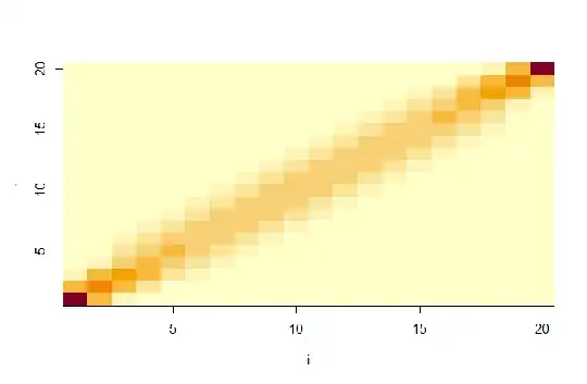

For $n=20$:
n <- 20L
y <- diag(0, n)
system.time(for (i in 1:n) for (j in 1:n) y[i, j] <- pnij(n, i, j))
#>    user  system elapsed
#>       0       0       0
image(1:n, 1:n, y, xlab = "i", ylab = "j")

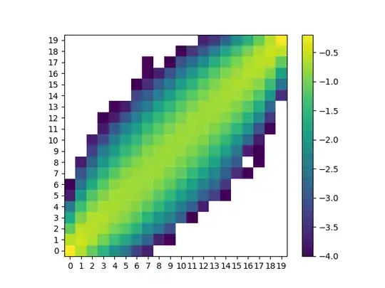

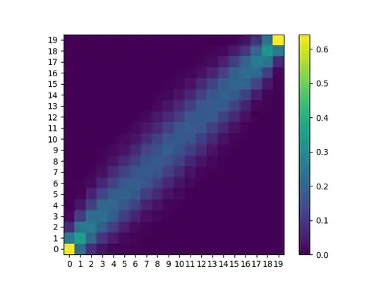

n = 20 ans = np.zeros((n,n)) for i in range(1,n+1): for j in range(1,n+1): ans[i-1,j-1] = solve(n, i, j)
plt.imshow(ans, origin='lower') plt.xticks(np.arange(1, 20, 1)) plt.yticks(np.arange(1, 20, 1)) plt.savefig('prob.png') plt.clf() plt.imshow(np.log(ans), origin='lower') plt.xticks(np.arange(1, 20, 1)) plt.yticks(np.arange(1, 20, 1)) plt.savefig('logprob.png')
I have obtained results that are identical to your random experiment: prob.png
