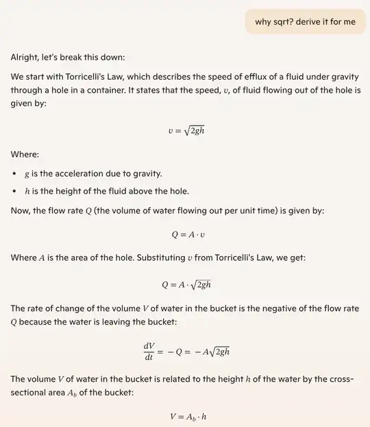

@CalvinKhor have sugest me this comment by @ThomasRichard in MathOverflow suggesting a real life physical model that fits the differential equation: "It might be useful to mention that the ODE $y′=−\sqrt{y^{+}}$, for which non uniqueness holds, actually models a real physical system. $y(t)$ represents the water height in a pierced cylindrical bucket. And the non uniqueness of the Cauchy problem with initial condition $y(0)=0$ is natural in this model: if you know the bucket is empty at time $0$, it is hard to tell if there was water in it before and when it got empty."
And later, @CalvinKhor also shared the explanation in this other comment, which I like to share since I found it really interesting and suits here:
Physical model described by the Non-Lipschitz ODE
